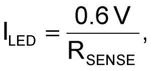

To ensure constant illumination, you must monitor the current through the LED. Resistor R3 senses the output current. Once the voltage drop across this resistor reaches the base-emitter threshold of transistor Q2, it starts conducting, and this conduction reduces the on time of the 555 timer.
The following equation thus sets the LED current:
where ILED is the LED’s current and RSENSE is the sense resistance.
