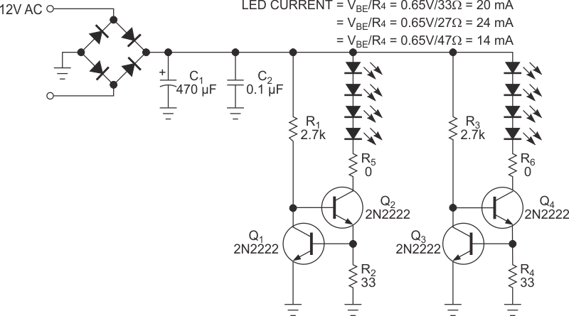

Keeping low-voltage outdoor lights illuminated takes some effort. Bulbs burn out, and connections corrode. HB LEDs (high-brightness light-emitting diodes) seem like acceptable replacements, but most are available only in surface-mount packages, which aren’t conducive to a backyard project. In addition, you must create a reflector for tiered lighting. Low-power LEDs, which come in finished packages, are more appealing, but you must have a way to drive them. Numerous driver ICs are available, but they, too, usually are available in surface-mount packages. Furthermore, the cost of the parts can add up to an expensive project. The simple two-transistor, two-resistor circuit in Figure 1 provides a better fit for this application.
Transistors drive LEDs to light the path
Figure 1. A simple two-transistor, two-resistor circuit is a good fit for outdoor-lighting applications.
The two transistors and two resistors act as a simple current source. Q1’s base-emitter voltage, VBE, combines with resistor R2 to set the LED current at approximately 20 mA. In this application, even a tolerance of ±10% doesn’t significantly affect LED performance. Thus, only the value of R2 is somewhat critical.
The 7 and 11 W incandescent outdoor lights in this setup receive their power from a 12 V-ac photoelectric timer. The bridge rectifier and filter capacitor produce approximately 15 V dc – enough to drive four white LEDs, each with an approximately 3.2 V forward- voltage drop. A small-value resistor, R5, may be necessary to offload some of the power dissipation of the main pass transistor. In this setup, however, Q2 dissipates only around 50 mW, so it can use just a jumper wire for R5 – hence, the schematic shows it with a value of 0 Ω. Two identical circuits on a round PCB (printed-circuit board) can drive eight LEDs, producing a relatively consistent light output using Cree C535A-WJN series 110°-viewing-angle LEDs (Figure 2).
