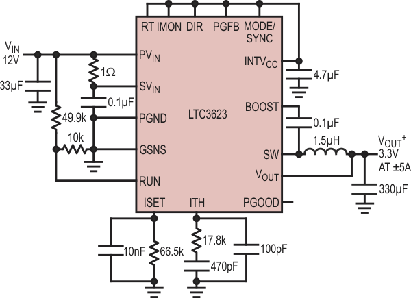

3.3 V Output, 1 MHz Buck Regulator
| Figure 1. | High Efficiency 12 V to 3.3 V 1 MHz Step-Down Regulator with Programmable Reference. |

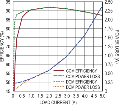

| Figure 2. | Efficiency and Power Loss for the Application in Figure 1 in CCM and DCM Mode. |

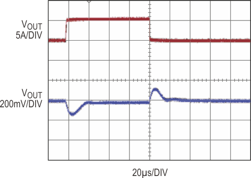

Figure 1 shows the complete schematic for a high efficiency 12 V input to 3.3 V output application. The compact package contains a low 30 mΩ RDS(ON) synchronous bottom MOSFET switch and a 60 mΩ RDS(ON) synchronous top MOSFET switch for high efficiency and minimal thermal issues. Figure 2 shows the continuous and discontinuous conduction mode efficiency and power loss. Discontinuous conduction mode significantly improves light load efficiency while adding a slight increase in output voltage ripple. Figure 3 shows the load-step response with only 330 μF of output capacitance.
| Figure 3. | 0 A to 5 A Load Step Response of the Figure 1 Schematic. | |

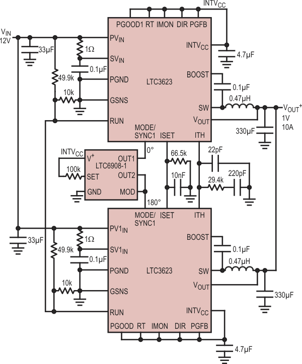

| Figure 4. | 12 V to 1 V at ±10 A 2-Phase Buck Converter. | |

Figure 4 shows a complete 1 MHz 12 V input to 1 V output dual-phase schematic capable of sourcing or sinking up to 10 A. The phases are synchronized by the LTC6908-1 oscillator with 180° interleaving to lower output voltage ripple. Figure 5 shows the efficiency and power loss for the overall system. The low thermal resistance of the LTC3623 package uses the PCB to dissipate heat. The thermal image is shown in Figure 6. From Figure 5, we can see that each phase dissipates 1.8 W at 10 A output current, which raises the chip temperature to 63 °C from an ambient temperature of with no airflow.
