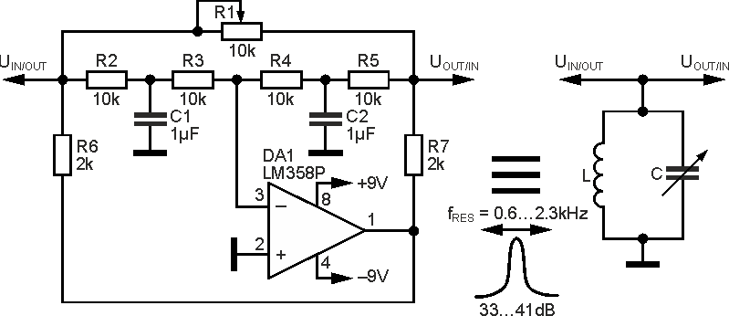

Based on the ideas presented in [3, 4], it is easy to synthesize new types of filters [5, 6], one of the variants is presented below in Figure 1.
| Figure 1. | The analogue of the parallel low-frequency electronic tunable LC-oscillatory circuit. | |
The resonant filter is an analogue of the parallel low-frequency LC-oscillatory circuit, made according to a symmetrical scheme using operational amplifier LM358P as an active element. With the elements indicated in the diagram, the filter can be adjusted with potentiometer R1 in the range from 0.6 to 2.3 kHz. It is recommended to install a limiting resistor of 100 Ohm in series with this potentiometer.
The equivalent Filter Quality goes down from 60 to 18, when the frequency is lowered. The transfer coefficient at a maximum transmission peak, depending on the frequency under the same conditions, falls from 41 to 33 dB.
The input and/or output shunting of the electronic analogue of the oscillating circuit with an active resistance of less than 300 kOhm in full analogy with the real LC-oscillating circuit reduces its equivalent q-factor.
