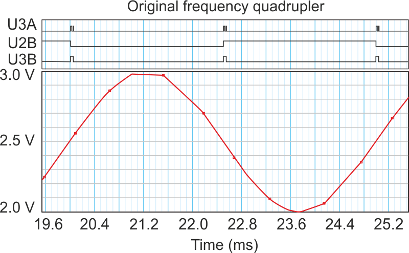

There is one issue with this simple implementation, though. The constant delay at U2D (as seen at U3B output) tends to cause counting-by-twos in the lower decades (Figure 2).
| Figure 2. | The circuit’s shortcoming is a tendency to initiate counting-by-twos at the lower ranges, due to the fixed delay time of gate U2D. |
