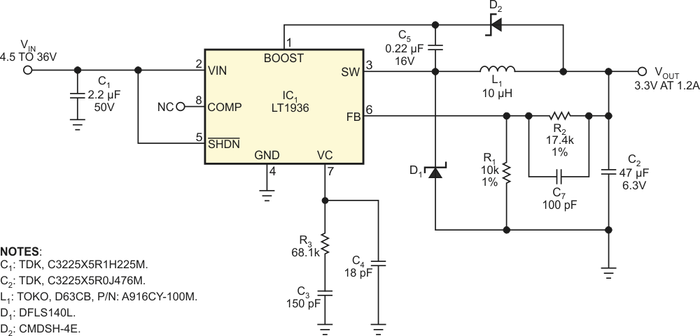

Internal operating voltages in electronic devices continue to decrease, but input-source voltages don't change. As the difference between input and output voltages increases, so does the improvement in efficiency that a switching regulator offers. Unfortunately, as a switched-mode step-down converter's output voltage decreases, the decrease imposes limitations on the circuit's input-voltage range. This Design Idea shows how to extend a low-output-voltage step-down converter's input-voltage range.
For efficient operation at output voltages of 3.3 V or higher, a charge pump comprising D2 and C5 provides a voltage boost that provides sufficient drive for IC1's internal switching transistor.
Figure 1. For efficient operation at output voltages of 3.3 V or higher, a charge pump comprising D2and Cprovides
a voltage boost that provides sufficient drive for IC1’s internal switching transistor.
A switching-mode step-down regulator, such as Linear Technology's LT1936 (IC1), includes an internal high-side NPN power transistor between its input, VIN, and switched-output (SW) pin. For highest efficiency, the high-side NPN transistor requires a base voltage that's higher than the input voltage. The circuit of Figure 1 works best for output voltages greater than 3 V. A charge pump comprising diode D2 and capacitor C5 maintains the voltage at the Boost pin 3 V above VIN. When IC1's internal power transistor switches off, the voltage at SW goes to ground through D1. Boost capacitor C5 charges to 3 V supplied from VOUT through D2. When the power transistor turns on, the voltage at SW jumps to VIN, and the voltage at the Boost pin jumps to VIN + 3 V, which provides sufficient head room to drive the power transistor into saturation for greatest efficiency.
