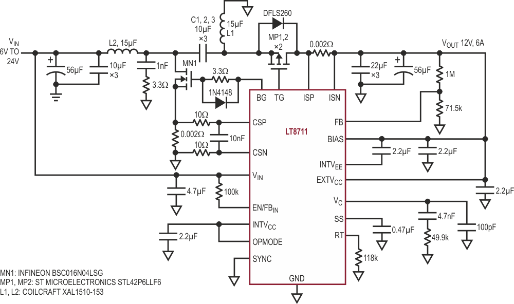

Figure 1 shows the schematic for a synchronous SEPIC converter using the LT8711, which controls a power train consisting of:
  • Two non-coupled inductors, L1 and L2
  • Modulating N-channel MOSFET, MN1, driven from pin BG
  • Two synchronous P-channel MOSFETs, MP1 and MP2, driven from pin TG
  • Decoupling capacitors, C1, C2, and C3
  • Input and output filters
Electrical schematic of LT8711 for SEPIC and buck applications.
Figure 1. Electrical schematic of LT8711 for SEPIC and buck applications.

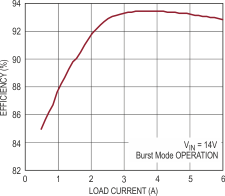

Figure 2 shows the efficiency of the converter with a 14 V input voltage. The synchronous scheme keeps efficiency high, reaching 93.4% at the peak. Figures 3 and 4 show output regulation as the input voltage falls below, and rises above, the output, which remains stable.
Efficiency of the LT8711 SEPIC.
Figure 2. Efficiency of the LT8711 SEPIC.
The standard demo circuit DC2493A [1] was reworked to increase output current from 4 A to 6 A. The MOSFETs MN1, MP1, and inductor L2 were replaced by the components shown in Figure 1.

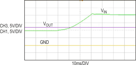

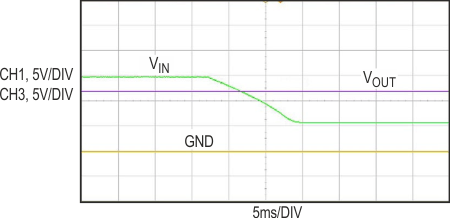

Model of a cold cranking event. The rail voltage VIN drops from 15 V to 6 V, but VOUT remains stable at 12 V.
Figure 3. Model of a cold cranking event. The rail voltage VIN drops
Model of a load dump. The rail voltage rises from 10 V to 20 V, but VOUT stays in regulation.
Figure 4. Model of a load dump. The rail voltage rises from 10 V to 20 V,
