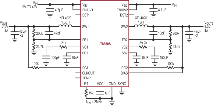

7.5 V/4 A and 3.3 V/4 A Outputs Have a Fast Transient Response
Figure 1 shows a dual output regulator designed to optimize the transient response. Although the LT8650S includes internal compensation, external compensation is used to minimize the transient response time and output voltage excursions. Switching is at 2 MHz, allowing higher loop bandwidth and a faster transient response.
7.5 V/4 A and 3.3 V/4 A outputs feature fast transient response.
Figure 1. 7.5 V/4 A and 3.3 V/4 A outputs feature fast transient response.

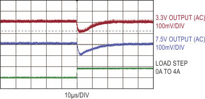

Figure 2 shows the output response to a 0 A to 4 A load step, where VOUT drops less than 100 mV for both the 3.3 V and 7.5 V outputs. This response is combined with high initial accuracy for a solution that meets tight VOUT tolerance.
0 A to 4 A transient responses of the circuit in Figure 1 (Burst Mode operation).
Figure 2. 0 A to 4 A transient responses of the circuit in Figure 1

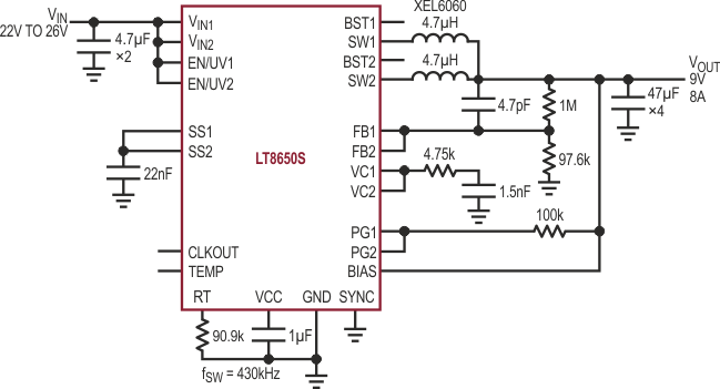

Paralleled Outputs Deliver 9 V/8 A from 24 V While Remaining Cool
The LT8650S packs two synchronous step-down regulators into a 4 mm × 6 mm package. The two outputs can be easily paralleled for high current as shown by the 72 W output, 24 V input design in Figure 3. Efficiency at full load is 95%, with the thermal performance of the board shown in Figure 4. Running at room temperature, the hottest part of the IC reaches about 75 °C without active cooling.
Paralleled outputs deliver 9 V/8 A from a 24 V input while remaining cool.
Figure 3. Paralleled outputs deliver 9 V/8 A from a 24 V input while remaining cool.
The temperature and efficiency are even better for a 12 V input. When paralleling, it is important to balance the current between the outputs by tying the outputs of error amplifiers together. This can be achieved by connecting VC1 and VC2 together and using external compensation. For applications that require a larger thermal budget, the LT8650H operates with a junction temperature.

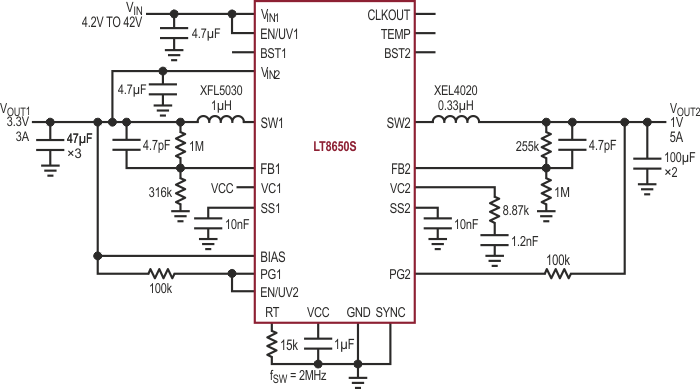

3.3 V/3 A and 1 V/5 A Running at 2 MHz for an SoC Application
Many system on a chip (SoC) applications require 3.3 V for peripherals and 1 V for the core. Figure 5 shows the LT8650S used in a cascade topology, where the input for the 1 V converter is powered by the 3.3 V output. There are a number of benefits of a cascade configuration over powering VIN2 from the main supply, including reduced solution size and constant 2 MHz operation.
Figure 5. 3.3 V/3 A and 1 V/5 A circuit running at 2 MHz for a SoC application.
The 4 A current rating per channel of the LT8650S is based on thermal limitations, but each channel can electrically deliver 6 A if temperature rise is managed with additional cooling. In the solution of Figure 5, the output power of the 1 V channel 2 is low, so it can deliver 5 A.
