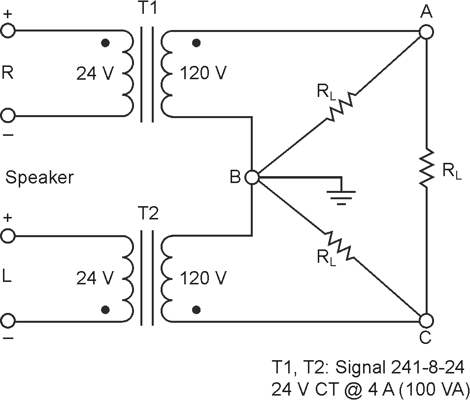

Before connecting, set the receiver volume control to its minimum setting and the balance, treble, and bass controls to their center positions. The three-phase supply’s output circuit consists of two 100-VA/24-V transformers T1 and T2 (Bel Fuse/Signal Transformer model 241-8-24) (Fig. 2). The primary and secondary windings are interchanged in this application, with the 24-V windings of the transformer connected to the receiver’s speaker terminals, while the 120-V windings are connected in a corner-grounded open-delta configuration that can supply up to 200 W of three-phase power.
A pair of standard, non-critical transformers converts the left and right receiver outputs into a three-phase topology.
Figure 2. A pair of standard, non-critical transformers converts the left and
Phase-to-phase voltages can be adjusted over a 0- to 120-Vac range, and maximum phase current is approximately 0.5 A. By connecting a full-wave rectifier (total of six diodes, two diodes per phase) to the output terminals, the receiver becomes a variable 0- to 100-Vdc/1.5-A dc supply with very low ripple.
