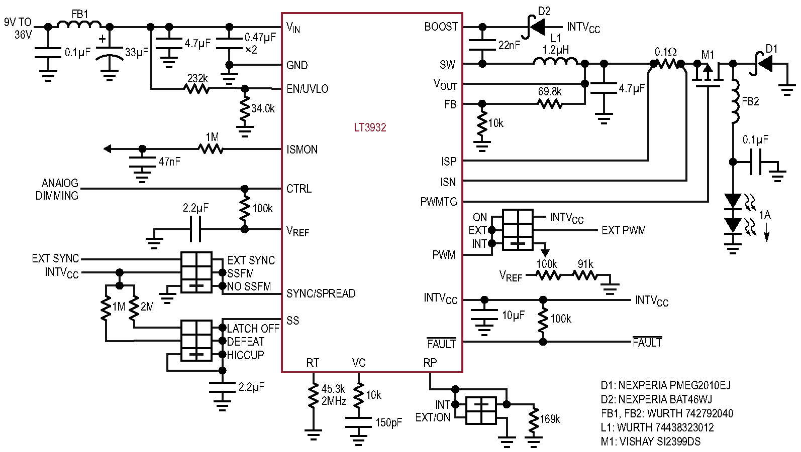

2 MHz Automotive LED Driver Features Low EMI and Internally Generated PWM Dimming with 90% Peak Efficiency Over the Input Range (~91% Efficient without EMI Filters).
Figure 1. 2 MHz Automotive LED Driver Features Low EMI and Internally Generated PWM Dimming with 90% Peak
The LT3932 synchronous step-down LED driver with integrated 36 V, 2 A switches features high ratio PWM dimming. The LT3932 houses its high efficiency integrated power switches inside a small 4 mm × 5 mm QFN package, and can be run at up to 2 MHz switching frequency for a compact, high bandwidth design. When high dimming ratio capability is not needed, and simplicity is paramount, its internal PWM generator can be used to produce 128:1 PWM dimming controlled by a simple DC voltage. With built-in fault protection to handle open and short LEDs, and spread spectrum frequency modulation to aid in reducing EMI, the LT3932 meets the demanding requirements of automotive and industrial LED lighting applications (Figure 1).

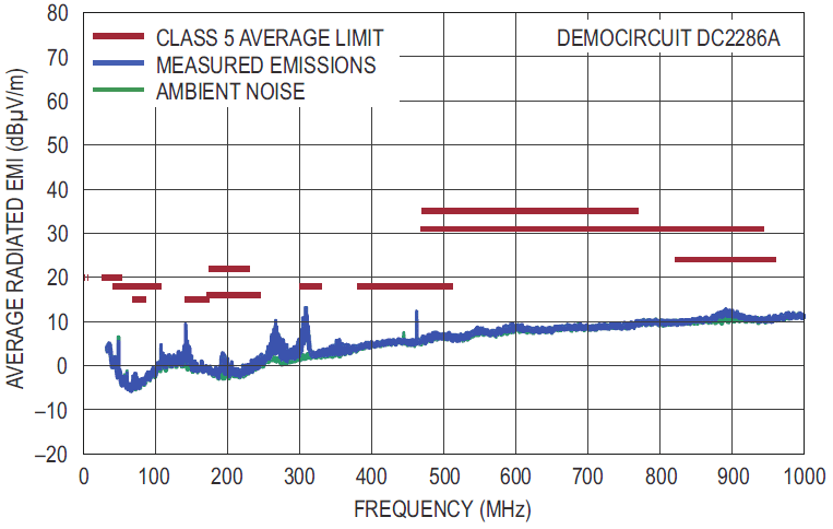

The efficacy of the LT3932’s low EMI technology is shown in Figure 2 – a radiated EMI scan of the production demo circuit for the LT3932 (DC2286A). It passes CISPR 25 Class 5 average limits, as well as peak limits.
The LT3932 Figure 1 Circuit Passes CISPR 25 Class 5 Radiated Average EMI.
Figure 2. The LT3932 Figure 1 Circuit Passes CISPR 25 Class 5 Radiated Average EMI.

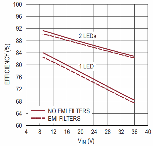

Figure 1 Efficiency Remains High While Driving 1 A LEDs at 2 MHz fSW, Even with Low EMI Filters.
Figure 3. Figure 1 Efficiency Remains High While Driving 1 A LEDs at 2 MHz fSW,

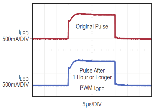

The LT3932 can reproduce a fixed on-time pulse of LED current with an indefinite off-time by maintaining its output charge while PWM is held low – no additional circuitry is required. Figure 4 shows two fixed-length on-time pulses of LED current produced by the LT3932, separated by one hour of off-time, demonstrating the LED driver’s ability to maintain its output charge during arbitrarily long PWM off-times. By preserving the state of the output, the LT3932 produces consistently shaped current pulses, regardless of the PWM off-time.
The LT3932 Faithfully Reproduces Current Pulses Regardless of PWM Off-Time - Important for Machine Imaging Applications that Demand Lighting Fidelity Over Time.
Figure 4. The LT3932 Faithfully Reproduces Current Pulses Regardless
of PWM Off-Time – Important for Machine Imaging Applications
