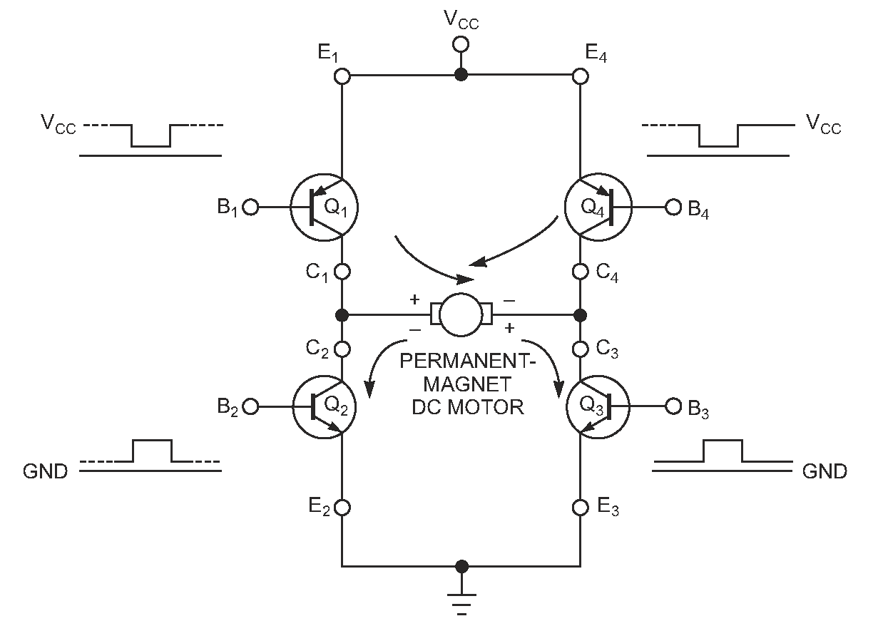

A traditional method of driving a low- to medium-power permanent-magnet dc motor involves using four MOSFET or bipolar transistors in an H-bridge configuration. For example, in Figure 1, the motor connects between collector pairs C1 and C2 and C3 and C4. Turning on diagonally opposite transistor pairs Q1 and Q3 or Q2 and Q4 steers current through the motor and allows for reversal of its direction of rotation. However, this method requires that each of the four transistors receive its own control input. Depending on the motor’s voltage requirements, the upper two drive signals may require electrical isolation or a level-shifter circuit to match the microcontroller’s output-voltage limitations.
In an H-bridge output-driver stage, diagonally opposed transistor pairs conduct to energize a dc motor. The circuit requires four control signals.
Figure 1. In an H-bridge output-driver stage, diagonally opposed transistor pairs conduct to energize
