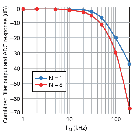

The combined frequency response of filter plus ADC  is flat out to a 10-kHz input.
Figure 2. The combined frequency response of filter plus ADC is flat

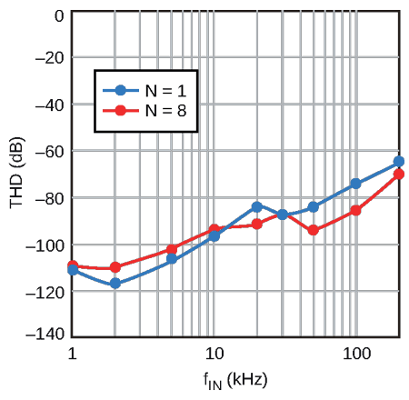

Details of THD versus input frequency show that it's always below -60 dB, even at 100-kHz input frequency, for both N = 1 and N = 8.
Figure 4. Details of THD versus input frequency show that it’s
always below –60 dB, even at 100-kHz input frequency,
Figure 2 shows the combined frequency response of the filter and ADC with a sample rate of 1.5 Msamples/s and number of averages (N) set to 1 and 8. Figure 3 is a PScope screen capture that shows the fast Fourier transform (FFT), SNR, and total harmonic distortion (THD) for the circuit with N = 1. (PScope is a USB-based product demonstration and data-acquisition system for use with Linear Technology’s high-performance ADCs and signal-chain receiver family.)

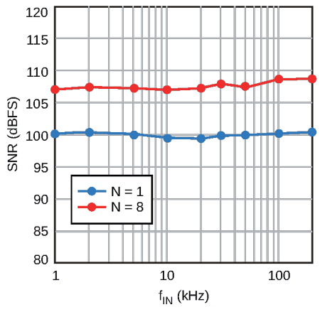

SNR is 100 dB and better out to 100-kHz input frequency, again for N = 1 and N = 8.
Figure 5. SNR is 100 dB and better out to 100-kHz input frequency,
Figures 4 and 5 respectively show THD and SNR versus input frequency, with N equal to 1 and 8. At input frequencies below a few kilohertz, performance is close to the typical datasheet numbers for SNR and THD, and THD gracefully degrades as the input frequency increases beyond that range.
