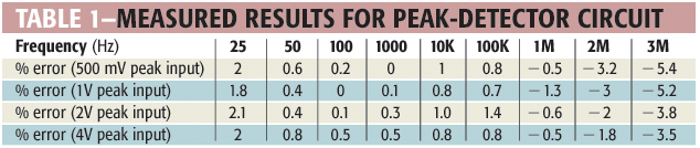

R13 and C6 filter the dc output to remove most of the noise that the comparator causes. R14 provides a small amount of attenuation of the dc output, so that R15 can provide approximately ±2% adjustment of the dc output. For best precision, set R15 for minimum gain and apply a 500-mV, 10-kHz signal to the input. Adjust R9 for 500-mV dc output. Then, apply a 4V, 10-kHz signal and adjust R15 for 4.010V-dc output. Check and repeat these two adjustments if necessary. If a precision ac source is not available, you can use an accurate dc source and a high-impedance voltmeter for calibrating the circuit. Apply 500-mV dc to the input and adjust R9 for 499 mV at Pin 10 of IC2. Then, apply 4V dc to the input and adjust R15 for 3.980V output (Pin 8 of IC2). The maximum peak input voltage is approximately 5V, because the maximum input-voltage specification for the LM306 is ±7V. The accuracy of the circuit decreases when the input peak is higher than 4V. Remember to use a blocking capacitor in series with the input if the signal to be measured includes a dc offset that can cause the peak input voltage to exceed approximately 5V. Table 1 shows measured results for the circuit. If desired, you can delete R9, R10, R14, R15, and R16 from the circuit and still obtain good performance.
