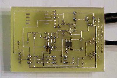

Printed Circuit Board
Jim Jennings has designed a single sided printed circuit board for this barometer, as he did previously for Version 1.1a. You can either make the PC board yourself or purchase it from Far Circuits. This new V2.0 board is universal in that it may be used to build either barometer V1.1a or V2.0.
1-Wire Barometer
1-Wire Barometer
