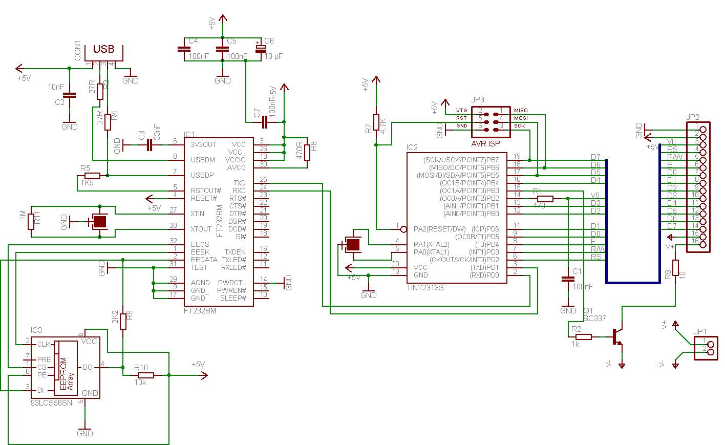

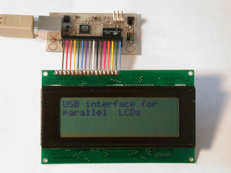

Adding a cheap LCD to your PC is a popular diy project for many beginners in electronics. The parallel port however, is dead. It's obsolete. It's big...ugly and just awful. The solution? Add a USB interface to your existing LCDs. The circuit interfaces to a standard HD44780 compatible LCD and emulates the CrystalFontz serial protocol over a virtual COM port created by the FTDI chip. This enables you to use already existing software to speak to the LCD, for example the popular program LCD Smartie. The circuit uses an AVR microcontroller, the tiny2313, and a USB chip from FTDI. The usb chip creates a virtual COM port on the computer. It has an external EEPROM programmable via USB to store information and settings. You can for example have the chip report back the name of your project when you plug it in. Very neat.
The backlight and contrast can be controlled from the computer. They are each connected to one of the PWM outputs on the AVR. Since the CrystalFontz protocol support software control of contrast and backlight, this seemed like a nice feature to add. Only LED backlights are supported, no EL backlights. The backlight can be powered from the USB port if its current draw is less than about 420 mA. If you need more, an external supply can be connected.

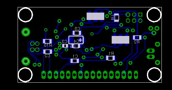

Schematic and board layout.
Click to enlarge
Component list.

Current limiting resistor R6 is only necessary if you want to power your backlight via the USB port. If you are doing so, +5V and GND to the backlight can be taken from the AVR ISP connector. Just connect a wire from the ISP connector to JP1 (the backlight supply connector). If you are using an external supply for your backlight, connect that to JP1 and replace R6 with a piece of wire. Note that the ceramic resonator connected to the AVR is there for a reason. Do NOT use the internal RC oscillator! Its frequency stability is very poor. Oh, and remember to set the fuses to use an external crystal and also unprogram the CKDIV8 fuse. The byte value to set the fuses (low byte fuses!) is 0xEE.
