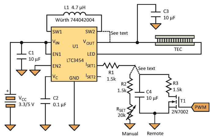

The circuit for controlling the TEC is fairly simple (see the Figure 1). If configured for manual setpoint control (R1 connected to R2), it requires only a handful of parts. An alternative configuration (R1 connected to R3) allows active setpoint control via a PWM signal from a microprocessor or FPGA.
When electro-optic components only need the thermal electric cooling of a light load for their temperature stabilization, an LED driver can serve as a low-cost current source and offer active or manual setpoint control.
Figure 1. When electro-optic components only need the thermal electric cooling of a light load for their temperature

Because TECs have lower impedance than LEDs, the driver’s efficiency can be expected to be lower than the (quite good) values the datasheet provides for standard applications. To measure the efficiency, substitute a 2-Ω resistor for the TEC as a load. This value is roughly the impedance of miniature TECs such as the Ferrotec 9503/023/020M. Tests showed that at 300 mA the efficiency was 50%, rising to 70% at 500 mA and to 75% at 700 mA and above.
The efficiency can be improved. Because VIN >> VOUT, the LTC3454 is running solely in buck mode and, according to the datasheet, one of the IC’s internal switches is always ON. Making a connection between pins six (SW2) and seven (VOUT) shunts out the switch, which removes its resistance from the circuit. The improvement is considerable, with efficiency at 300 mA becoming 70%, rising to 77% at 500 mA and to 80% at 700 mA and above. All efficiences were measured at VIN = 5 V. At VIN = 3.3 V, the values were a few percent higher.
