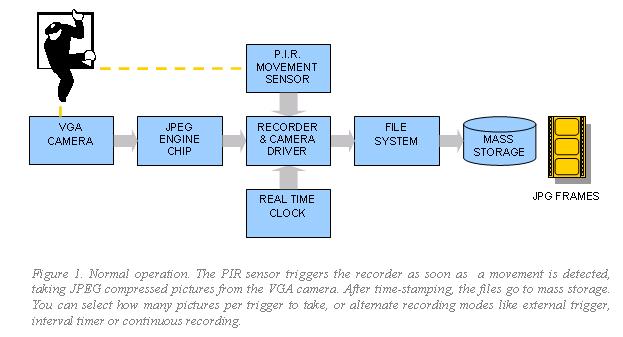

These two blocks are the foundation and starting point of the Witness Camera design. With the aid of the simplified block diagram of Figure 1, let’s see how these block interoperate during normal operation as a time-lapse recorder.
Witness Camera
This diagram introduces a second hardware block, the PIR (Passive Infra-Red) movement sensor model ITM256. This module can sense people up to 5 meters/16 feet away, by measuring changes in the infrared radiation caused by human body temperature. It is a cheap mass-production part from the burglar alarm market, including a Nicera RE200B thermopile and a KC778B companion chip in dice form, under the familiar epoxy blob. A Fresnel lens with an angle of 60º snaps in the PCB, which connects to the outside world by means of a short 3-pole cable (power, ground and signal).
The PIR triggers a software block, the recorder, which is in charge of deciding if and how many pictures to take according to its trigger inputs and operating mode. The recorder controls the camera driver (another software module) in order to get the JPEG byte stream. The real-time clock is an hardware feature of the AVR controller, and the recorder uses it both for time-stamping the JPEG files with current date and time, and as an interval timer if time-lapse photography mode is selected. After time-stamping, the recorder hands over picture data to the file system, which stores it permanently on the SD-card.

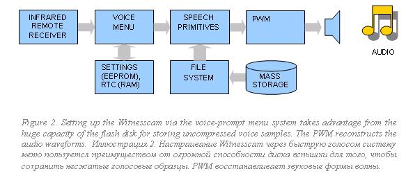

During setup the user interacts by means of an infrared remote control (I have used an off-the-shelf universal remote), and the Witnesscam responds with voice prompts. The prompts guide the user through the editing of all the operating parameters (date, time, recording mode, picture resolution, number of frames to take each time the sensor triggers…).
The voice menu block is the software module running the user interface. It takes the pulse train from the infrared receiver as input, and after decoding it uses it to edit the settings from AVR’s non volatile memory. During this process, it invokes the speech synthesizer module, which provides the primitives needed to compose and play the messages.
The speech synthesizer takes advantage from the existing mass storage capabilities, using the file system in read mode. The flash disk must be prepared in advance with a special set of files with audio samples for each word or status messages to be pronounced, e.g. the file “15.PCM” stores the waveform samples for the word “fifteen”. Reconstructing the audio signal is then a matter of opening the file and sending the samples to the AVR PWM feature.
Samples compression is unnecessary. Years ago, devoting more than one megabyte of flash for this purpose would have been regarded as extravagant opulence, but today this figure represents about 0.1% of flash disk capacity! So this technique is cheaper than an LCD display, and ways more effective, because it’s expected that the camera is concealed or placed out-of-the-way.

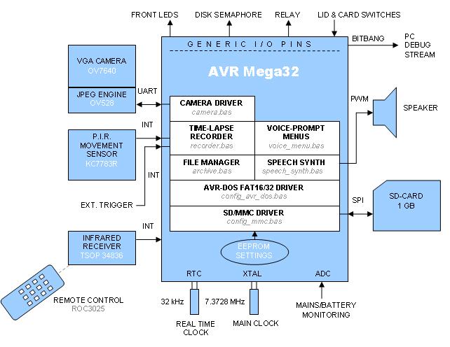

The complete block diagram of Figure 3 is the sum of the two previous diagrams plus some extra details. The software modules are draw inside the AVR Mega32 body. For ease of reference, the respective source file names are given in italics.
Witness Camera
This chart shows the file system exploded into its constituents: the AVR-DOS library, the underlying SD-MMC software driver which takes care of low-level access to the physical media, and the SD-card itself. The card talks to the AVR via the hardware SPI interface, which is notably fast in Mega devices.
There is a new file manager layer (file archive.bas) mediating between the recorder and the AVR-DOS file system. Its purpose is to provide helper functions like determining the oldest files in the archive, deleting unused stuff to make room for new images, and creating an orderly set of directories and files to archive the pictures according to the time stamp.
Another added functionality, introduced in order to preserve disk integrity, is power monitoring. The system must cease any disk write in case of problems. It measures both main and battery voltages using the 10-bit AD converter of the AVR.
The remaining functions are not essential for the Witnesscam to work, but make development and use much easier. With the PC debug port you can log system operations messages (disk size and free space, JPG file size, read and write file access details, remote control codes received) for diagnostic purposes – or just for the pleasure of watching the internal clockwork in action.. I created the port bit-banging an I/O pin, a technique that works perfectly for low baud rates (9600) and allows setting of signal polarity. That is, you can connect the AVR pin straight to the RX pin on PC serial port, without any interface logic (a priceless trick for debug).
The AVR can drive LEDs from all of its general purpose I/O pins. I have provided two status indicators on the front panel. They are useful to verify the PIR sensor range and to check if disk is actually recording.
Notably, I have introduced two extra LEDs inside the box, next to the SD-card slot. I call this the “disk semaphore”: when the green light is on, it’s safe to extract or insert the SD-card from its slot. A red light signals that a disk operation is in progress, and you must wait before touching the SD-card. A simple algorithm inside the main recording loop determines what light to put on based on the status of the recorder, the card detect switch from the SD-card receptacle, and the lid detector switch that notifies the system when the camera case is opened.
