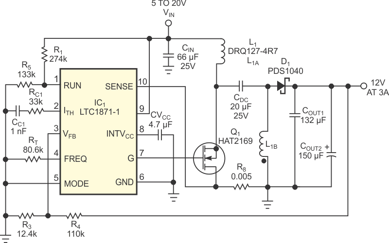

A single-phase SEPIC has low input ripple currents and is suitable for power levels of 5 to 50 W.
Figure 1. A single-phase SEPIC has low input ripple currents and is suitable for power levels of 5 to 50 W.

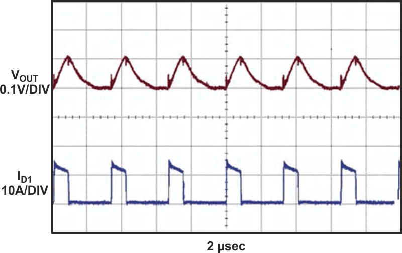

The single-phase SEPIC circuit can generate 3 A of output current (Figure 1). SEPICs are typically 1 to 2% more efficient than flyback converters. Figure 2 shows the output diode's current (bottom trace) at minimum input voltage and maximum load and the output-voltage ripple (top trace). The circuit's output capacitors must handle the peak output-diode current of 14 A. Even though the circuit uses four low ESR (equivalent-series-resistance) output capacitors, output-voltage ripple is still 110 mV p-p. The aluminum output capacitor, COUT2, doesn't help much in reducing the output ripple due to its much higher ESR. COUT2 mainly helps reduce load transients by adding bulk capacitance to the output rail.
The single-phase circuit in Figure 1 has a peak capacitor output current of about 14 A (bottom trace).
Figure 2. The single-phase circuit in Figure 1 has a peak capacitor output current of

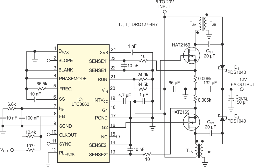

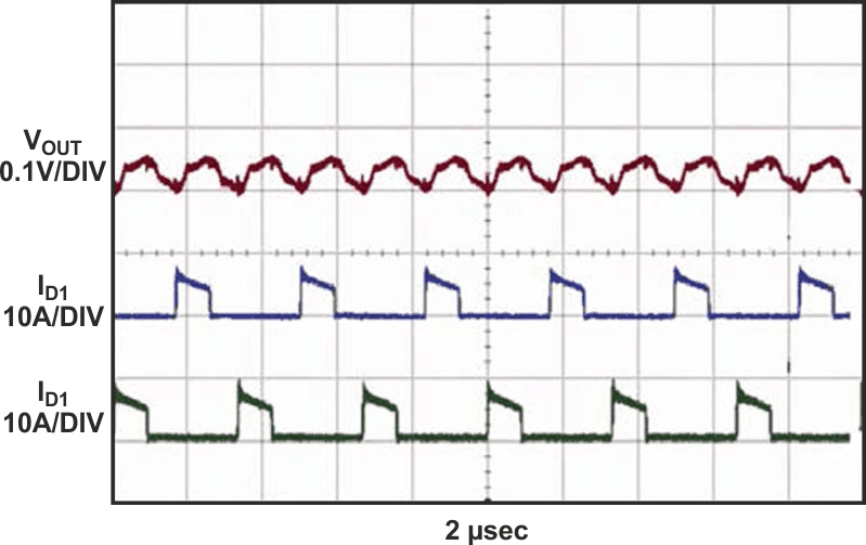

Figure 3 shows a two-phase converter, which is similar to the single-phase converter in Figure 1 except for the addition of an identical second-phase power stage. The second phase halves the peak inductor, MOSFET, and output-diode currents. The 50% lower peak output-diode currents produce 50% lower output ripple (Figure 4). Also, the output-ripple-current frequency doubles, thus making it easier to filter out with an additional LC filter if necessary.
By adding second power stage and shifting the phase by 180°, you can reduce the output ripple currents by more than 50%.
Figure 3. By adding second power stage and shifting the phase by 180°, you can reduce the output ripple currents
by more than 50%.

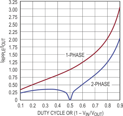

The benefits of using a dual-phase converter become clear when you consider output-capacitor ripple current (Figure 5). The two-phase converter's output-capacitor ripple current is always lower than that of an equivalent single-phase converter. Depending on the duty cycle, the two-phase converter's output-capacitor ripple current can approach 0 A at a 50% duty cycle. Inductor ripple current is still present, and you can reduce it by using larger inductors.
The output ripple current is 50% lower for a two-phase SEPIC. The output ripple voltage is 50% lower than that of a single-phase design with the same output capacitors.
Figure 4. The output ripple current is 50% lower for a two-phase SEPIC. The output

The normalized output-capacitor ripple current for single- and dual-phase SEPICs shows lower output ripple with a two-phase design.
Figure 5. The normalized output-capacitor ripple current for  single-
a two-phase design.
