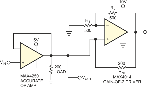

Figure 2 presents a practical application of the concept. The first op amp is an accurate, unity-gain buffer, and the second op amp is a high-current, high-bandwidth, gain-of-2 driver. Because R1 = R2 in this negative-resistance stage, its input resistance is –RNF = –200 Ω, which matches the magnitude of the accurate buffer's load resistance. If these magnitudes match perfectly, the buffer sees an open circuit at its output. The buffer drives the positive input of the second amplifier, and the second amplifier, via its negative-resistance input, drives the load. Gain error, output-current limits, and resistor mismatches limit the minimum resistance the circuit can drive, but driving a 200 Ω load is easy. That load is an order of magnitude lower than the load the unassisted accurate amplifier can handle without suffering degradation of performance. Note that the second op amp's gain error, offset voltage, and offset current do not affect the first op amp's accuracy. The step response of this circuit is well-behaved and exhibits no ringing.
Connecting a negative resistance in parallel with the load enables a precision op amp to drive 200 V.
Figure 2. Connecting a negative resistance in parallel with the load enables a precision
The negative-resistance approach works equally well with dual-supply op amps, because the negative-resistance portion can both source and sink current. If the driver op amp does not have built-in gain-setting resistors, you can set its noninverting gain closer to unity, thereby allowing both op amps to share a power supply. This approach limits the output swing of the accurate op amp, but that restriction may be acceptable in a given application. To ensure full bandwidth for the accurate op amp, the driver op amp should have much higher bandwidth.
