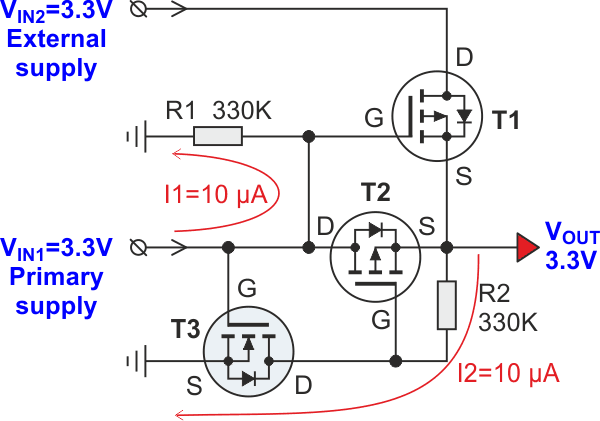

The circuit in Figure 1 turned out to be crucial when I wanted to increase the overall efficiency in my design of a very low-power portable datalogger for long term use.
This simplified discrete circuit for ORing power supplies offered improved efficiency over a diode-based approach.
Figure 1. This simplified discrete circuit for ORing power supplies offered improved
Here is a brief description: If the primary power supply (VIN1) is present, the N-channel MOSFET transistor T3 is ON, which pulls down the gate of the P-channel MOSFET T2 and turns T2 ON. Transistor T1 sees as its gate-to-source voltage (VGS) the drain-to-source voltage (VDS) of T2, which is only tens of mV. So, T1 is OFF and the external supply path (VIN2) is open.
Now, in the case of an intermittent VIN1 blackout, T3 turns OFF because its gate is pulled down through R1, which turns T1 ON. The transistor T2 is turned OFF as its gate is pulled up thru R2 (VGS of T2 is almost null).
The MOSFET transistors T1 and T2 should be chosen with low-level gate and very low on-resistance features (for instance: T1 = T2 = PMN50XP, which have RDS(ON) of 60 mΩ at VGS = 3.3 V). Transistor T3 can be a popular 2N7000 (or 2N7002 for surface-mount parts).
The circuit’s quiescent current is about 20 μA when the primary supply is present, and almost null otherwise. So, a battery is suitable as the external supply.
The values of R1 and R2 are not critical. They can be hundreds of kΩ if we prefer to obtain a very low quiescent current, or tens of kΩ if we prefer to decrease the swap time commutation between input supplies.
