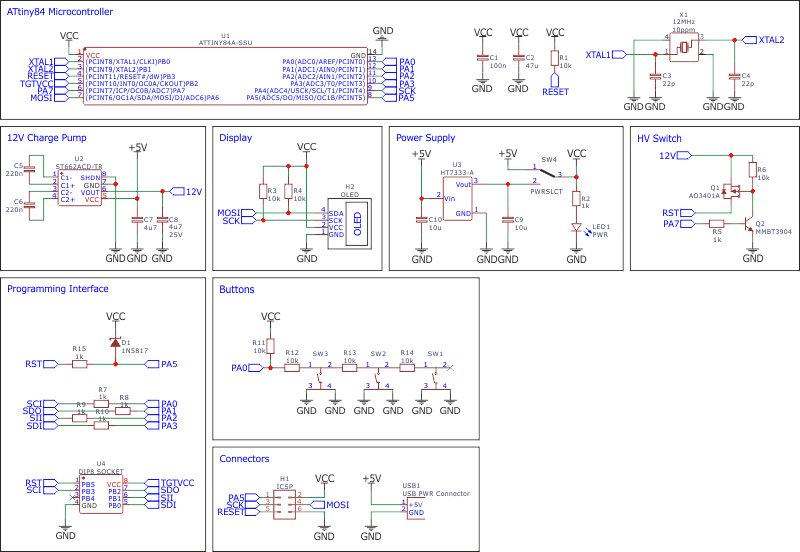

The TinyCalibrator is supplied with 5 V via a Micro USB connector. Since the frequency of the oscillator depends on the supply voltage of the ATtiny, an HT7333 voltage regulator was integrated. A switch can then be used to choose whether the oscillator should be calibrated for 3.3 V or 5 V.
The ATtiny84 was chosen as the microcontroller for the TinyCalibrator because it has exactly the necessary number of GPIO pins. For accurate frequency measurements, the ATtiny84 is operated with an external 12 MHz crystal. Since the current software version only requires about 3.7 KByte, an ATtiny44 can also be used.
OSC Calibrator and High-Voltage Fuse Resetter Schematic Diagram.
Figure 2. OSC Calibrator and High-Voltage Fuse Resetter Schematic Diagram.
To generate the 12 V for the High-Voltage Serial Programmer, an ST662A charge pump IC was chosen, which was specially designed for such applications and needs only a few external components. The 12 V is controlled by a MOSFET and applied to the RESET pin of the target ATtiny if necessary. The remaining programming lines to the target are protected against a short circuit with resistors.
The user interface utilizes three buttons and a 128×64 pixels OLED display. All project files available in download section and project page on Github.com [1].

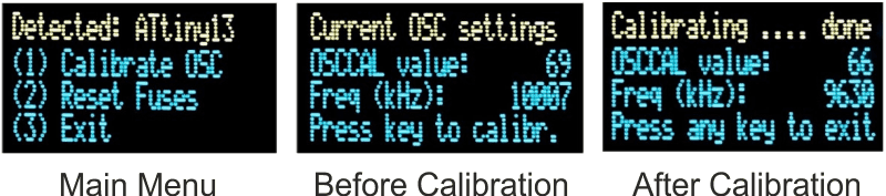

To carry out the calibration, a program is first uploaded to the target ATtiny using the integrated High-Voltage Serial Programmer. In addition, the factory oscillator calibration value (OSCCAL) is written to the EEPROM. The program on the target ATtiny reads the EEPROM and writes the value to the OSCCAL register. Then it applies an oscillating signal with half the clock frequency to pin PB0. Since the fuses were previously set so that the target ATtiny runs with a prescaler of 8, a signal with 1/16 of the oscillator frequency is applied to PB0.
This frequency is measured by the TinyCalibrator and compared with the target value. The oscillator calibration value (OSCCAL) is then adjusted accordingly and written to the EEPROM of the target ATtiny. This process is repeated until the OSCCAL value, which leads to the lowest frequency deviation, has been found.
TinyCalibrator: Optimal OSCCAL value found.
Figure 3. TinyCalibrator: Optimal OSCCAL value found.

  • Select the desired supply voltage (3.3 V or 5 V) with the switch.
  • Connect a 5 V power supply to the micro USB port.
  • Place the ATtiny13/25/45/85 in the IC socket and press any key. Use an SOP adapter for SMD parts.
  • Select the function you want and follow the instructions on the display.
After the calibration process, the optimal OSCCAL value remains in memory address 0 of the EEPROM and can continue to be used. To do this, program the EEFUSE to preserve EEPROM memory through the chip erase cycle, otherwise the OSCCAL value will be lost after uploading new firmware. Your code should then contain the following function:
Of course, the OSCCAL value can also be set directly without the EEPROM. Remember that the OSCCAL value is displayed in hexadecimal (for example, OSCCAL = 0x66).
