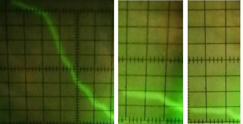

You can directly measure the DAV estimate using any high-resistance (RI > 10 MΩ) voltmeter connected as shown in Figure 1. A voltmeter with no less than 4.5 digits resolution is preferable because it is possible DAV will be quite small. To have stable readings, however, the voltmeter’s time constant C1 × RI should be much greater than the cycle duration (t). In some cases, this can be a problem, so a scope may be preferable to a voltmeter. In the case when two capacitors of the same capacitance are being compared, the scope can also provide more obvious readings.
Examples of DA measurements taken with this circuit are shown in Figure 4, using a scope instead of a voltmeter. Results for three capacitors with the same capacitance (CUT = 220 nF) but different dielectrics – polyester film (PET/mylar), PP, and PS – are shown. The scope is set to 10 mV/division and the test circuit parameters were: E = 100 V and C1 = 100 nF.
Representative DA measurements for three capacitors of the same value clearly show the differences in their dielectric types.
Figure 4. Representative DA measurements for three capacitors of the same value clearly show

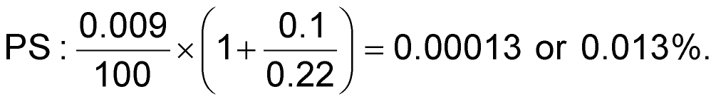

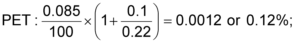

For the PE capacitor, the DAV output pulse amplitude is about 85 mV, for the PP capacitor this amplitude is about 18 mV, and for the PS capacitor it’s only about 9 mV. Thus, the distinction between dielectric types is quite evident.
Calculating the DA value (DAV/E) with the sampling error correction, we get:
This data is in good agreement with datasheet references.
