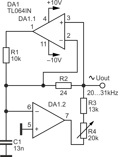

Sine-wave oscillator on the TL064IN chip.
Figure 2. Sine-wave oscillator on the TL064IN chip.
The oscillator in Figure 2 uses the TL064IN IC. This circuit also differs from the previous one in the values of RC parts and supply voltage. With the help of the potentiometer R4, the generator is tuned in the frequency range from 20 to 31 kHz. In this case the harmonic distortion changes from 0.85 to 0.45%, and the output signals amplitude varies from 180 to 230 mV. Sinusoidal signals can also be taken directly from the outputs of operational amplifiers, for example, from the DA1.2 output, where the signal amplitude is 8.4 V but with harmonic distortion 1.32%.

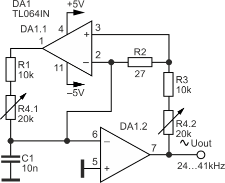

A variant of the sine-wave oscillator on the TL064IN chip.
Figure 3. A variant of the sine-wave oscillator on the TL064IN chip.
The oscillator in Figure 3 uses a dual potentiometer R4.1, R4.2 to adjust the oscillation frequency. This oscillator operates in the frequency range of 24...41 kHz. The amplitude of the output signal depends little on the frequency. At a supply voltage of 5 V and a frequency of 24 kHz, the signal amplitude is 3.25 V (harmonic distortion is 0.05%); at a frequency of 41 kHz, the signal amplitude is 3.33 V (harmonic distortion is 0.64%).
The oscillator frequency in Figure 3 is inversely proportional to the square root of the C1(R1+R4.1) product. The value of the C1 capacitor should be in the range from 10 to 100 nF.
