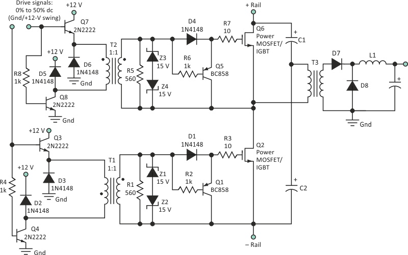

The design shown in Figure 1 allows the drive signal to the MOSFET to range from 50% down to 0%, while still offering a fast turn-off that cannot be accomplished with a simple load resistor. When T1’s primary is energized, the secondary delivers current through D1, charging the gate.
| Figure 1. | This gate drive transformer circuit provides the MOSFET drive signals ranging from 50% down to 0% while maintaining a fast turn-off time. |
When the transformer’s primary is released, the secondary delivers a low-energy negative spike, then goes to zero. While any charge remains in Q2’s gate, Q1 shunts the current directly to Q2’s source, using the transformer’s secondary only as a control signal. This allows the gate capacitance to be discharged rapidly.
To significantly widen the number of transformer choices, the circuit uses a primary drive scheme that does not require a separate reset winding to be included for the GDT. Of course, multiple secondaries may be used for controlling several devices, each with its own secondary circuit.
| Figure 2. | A typical forward-converter application uses two of the gate drive transformer circuits connected as shown. |
Figure 2 shows the circuit used in a typical forward-converter application. The back-to-back zener diodes are intended to clamp any voltage spikes that would be caused by leakage and stray inductances. However, the 560-Ω load resistor, together with the gate capacitance and a low-leakage transformer design, is usually enough to suppress such spikes, so the zeners may not be needed.
