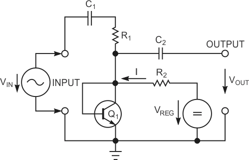

AGC preprocessing suppresses the absolute amplitude of a sensed signal while preserving the best possible resolution of individual spectral components' relative amplitudes. The circuit in this Design Idea offers one relatively simple and efficient approach to per-channel AGC. The circuit uses a method of direct low-level signal control using a short-circuited bipolar transistor. In Figure 1, a variable voltage divider comprising a fixed resistance, R1, and a variable resistance controls the signal's ac amplitude. The variable resistance comprises the differential resistance of a bipolar transistor, Q1, short-circuited from base to collector. To vary Q1’s resistance, you force direct current into the shorted transistor from a current source comprising voltage source VREG and a high-value resistor, R2. To prevent R2 from affecting the circuit's ac-voltage-transfer characteristic, R2’s resistance must greatly exceed R1’s.

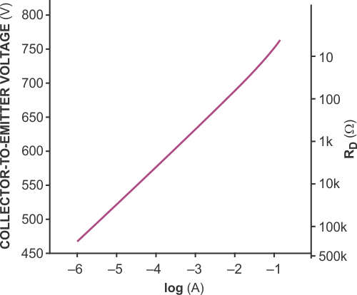

For all reasonable values of positive current I – generally, less than the transistor's maximum rated emitter current (IE) – transistor Q1’s collector-to-emitter saturation voltage is less than its base-emitter threshold voltage, and the transistor operates in the active state. The shorted transistor's VI (voltage-versus-current) characteristic curve strongly resembles that of a PN diode and follows Shockley's Equation except for slightly higher dc-voltage values. That is, the device's voltage variation is proportional to the logarithm of the dc-current variation.
Therefore, the shorted transistor's differential resistance at every dc operating point along the VI curve is inversely proportional to the passing dc current; in other words, the device's differential conductance is directly proportional to the current. Because, in its active state, a common-emitter-connected bipolar transistor's current-amplification factor is typically 100 or more, the differential resistance accurately follows this rule over a broad range of currents.
Thus, varying VREG in Figure 1 varies the current, I, and controls the R1-Q1 voltage-division ratio. Coupling capacitors C1 and C2 separate the circuit's attenuator from the input-signal source and output load. Figure 2 illustrates a typical small-signal bipolar transistor's short-circuited VI characteristic, showing that you can control differential resistance over at least five decades of range – that is, more than 100 dB.
A VI characteristic shows the corresponding differential-resistance graph for a short-circuited BC337-16 transistor. (Note: The -16 denotes a sorted hFE range of 100 < hFE < 250.)

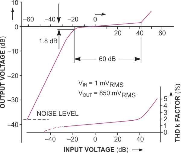

Figure 4 shows the circuit's input-versus-output characteristics as measured with a sine-wave signal. The effective AGC range extends from 100-µV- to 100-mV-rms input voltage, a 60-dB dynamic range. Output voltage varies less than 2 dB over this input range, reaching a nominal level of 775 mV rms at a –20-dB- (100-µV-rms) input level. The input's 0-dB point is set arbitrarily at 1-mV-rms input, which corresponds to an 803-mV-rms output. The AGC attack time for a sinusoidal-input-signal step from 0 to 100 mV rms is approximately 0.3 sec, and the AGC release from 100-mV-rms input to –20 dB (100 µV rms) is approximately 100 sec. Figure 4 also includes a graph of THD versus input voltage. The distortion is well below a 5% THD limit throughout the input-voltage range.
The circuit's input-versus-output characteristic shows a 60-dB control range (upper trace) and total harmonic distortion well below 5% over the control range (lower trace).
Figure 4. The circuit’s input-versus-output characteristic shows a 60-dB
To measure the attenuator's baseline input noise, terminate the input with its nominal 1-kΩ source resistance. At low input voltages, input stage Q1’s noise limits the processed signal's usable dynamic range. The rms noise level is about –38 dB relative to the nominal output for input signals below the AGC threshold. When the AGC becomes active, the SNR increases in proportion to the AGC reduction. For example, with a 0-dB- (1-mV-rms) input signal, the SNR increases to approximately 60-to-1.
