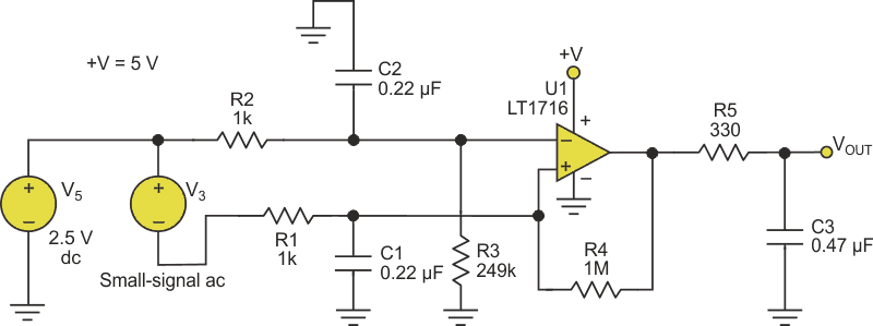

The improved circuit (Fig. 2) operates as described previously, except the output is rectified low by the weak pull-up and strong pull-down of the comparator’s asymmetric output stage, without the need for an external diode and its attendant forward diode drop. R5 limits the peak pull-down current.
Because U1 incorporates an asymmetric output stage (weak-pull-up/strong-pull-down), the improved circuit does not require a diode, which eliminates the forward diode voltage drop.
Figure 2. Because U1 incorporates an asymmetric output stage (weak-pull-up/strong-pull-down), the improved circuit

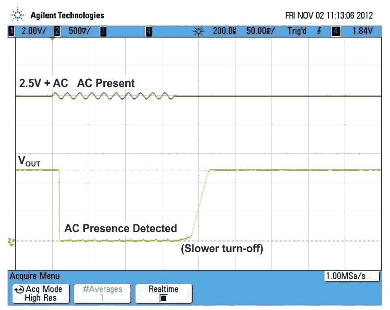

Although the application called for the detection of a 60-Hz signal, R1/C1 allows an input detection bandwidth of about 700 Hz, which can be extended to about 40 kHz if C1 is removed (tested at 20-mV peak signal level). The output rate is limited by the R5/C3 tau and has a much slower turn-off than turn-on, due to the weak internal pull-up (Fig. 3). The digital output high is set by the LT1716 supply voltage, 5 V as shown.
Lab tests of the circuit in Figure 2 show that it detected the ac signal on the 2.5-V dc and rectified it to a 5-V digital output, VOUT. Note the slower turn-off compared to the turn-on.
Figure 3. Lab tests of the circuit in Figure 2 show that it detected the ac signal on
