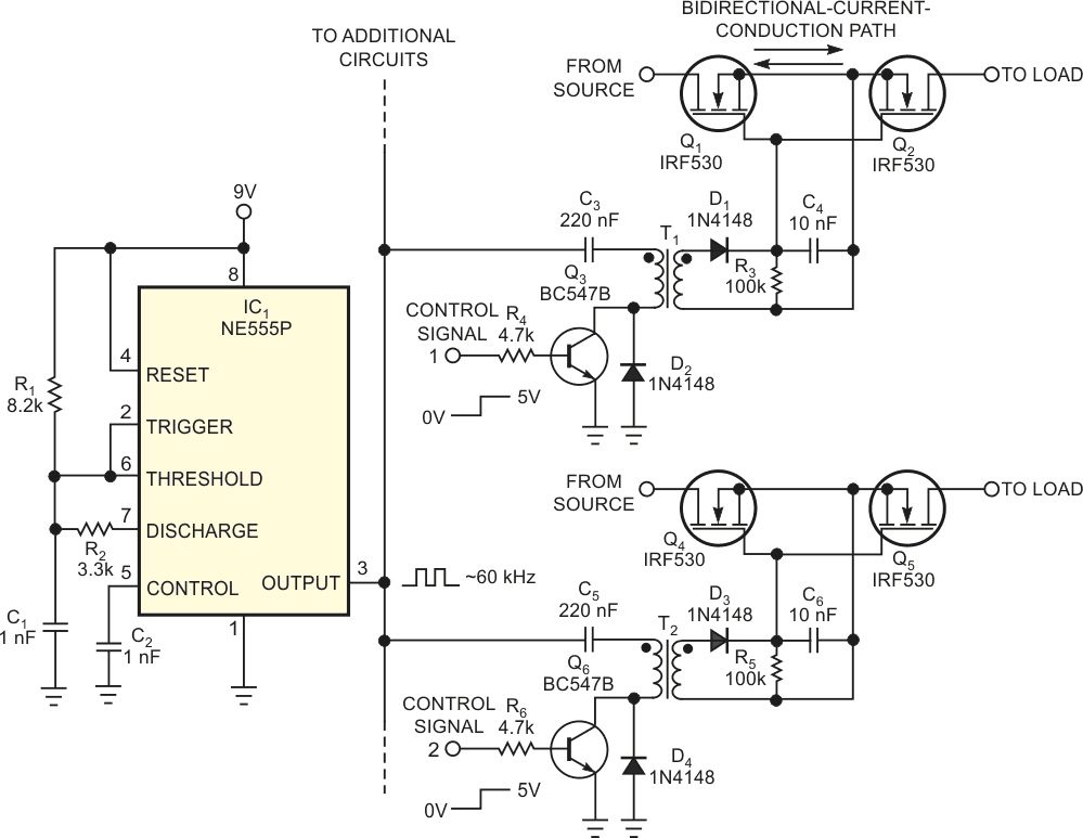

As an alternative to a conventional relay, a series-connected pair of MOSFETs can replace a contact in an ac circuit (Figure 1). A pair of IRF530 devices switches loads in circuits with peak maximum voltages as high as ±100 V. Based on the well-known 555 timer, an astable oscillator, IC1, provides a source of square-wave voltage to drive the MOSFET pairs' gate. Resistors R1 and R2 provide charge and discharge paths for timing capacitor C1. The 555's output stage can sink and source several tens of milliamperes and provide enough current to drive as many as 10 stages' simultaneously operating switch gates, each consuming 5 mA of peak current; the 555's output sinks a maximum of 50 mA at an on-state maximum voltage of 0.75 V. The 555's output drives a distribution bus that provides power to an array of pulse transformers, T1 and T2. Capacitor C3 in series with the transformers' primary removes the dc offset voltage that would otherwise appear across the winding.
| Figure 1. | A single 555 oscillator provides square-wave ac gate drive to an array of as many as 15 MOSFET-based solid-state relays. |
Selection of the transformer is not critical, and any ferrite-core pulse transformer that can provide gate voltage to the MOSFETs and maintain a safe level of voltage isolation can function in the circuit. For example, you can use C&D Technologies' 76601/3, which provides a 1-to-1 turns ratio at a primary inductance of 219 µH with 500 V-dc interwinding isolation.
Applying a control signal to the base of general-purpose NPN switching transistor Q3 allows collector current to flow through the primary of its associated transformer. Diode D2 provides a reverse-current path through the winding. On the secondary side, diode D1 rectifies the secondary voltage and charges capacitor C4, which filters the rectified voltage to improve noise immunity and reduce voltage ripple at the MOSFETs' gates. Removing the control signal switches off Q1 and Q2. Resistor R3 provides a discharge path for C4, allowing the MOSFETs to switch off in approximately 3 msec. For faster turn-off, you can reduce the value of either C4 or R3 at the expense of increased ripple on the rectified gate voltage.
Using two series-connected MOSFETs allows bidirectional ac conduction through the pair. When the MOSFETs are off, their parasitic diodes connect in series opposition and thus block conduction. You can select from among a range of MOSFETs to match your application's requirements, but make sure that the voltage you apply to the gates of Q1 and Q2 is sufficient to fully switch both devices into full conduction. The IRF530 has a gate threshold voltage of 3 V, but applying a gate-source voltage of 10 V ensures low on-resistance. You can adjust the gate-source voltage by altering the transformer's turns ratio or IC1's power-supply voltage within its 4.5 to 16 V rating (reference 1 and reference 2).
