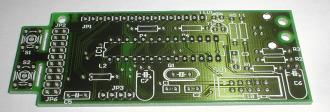

The final pcb mounted on a 4×20 display The USB connector is mounted on the rear PCB side

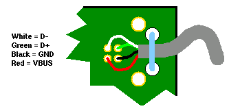

The USB connection may be done via a USB B style connector. This is the square connector that is typically used for USB devices (unlike the flat A style connector used at USB hosts). The USB connector is to be mounted at the solder side (the rear side of the PCB without the white printing). Mounting it to the component side may damage the LCD2USB or even the PC when plugging it in. Alternally a cable may directly be attached to the component side of the board as depicted in the image below.
Direct attachment of an USB cable The minimum working setup for pre-flashed CPUs

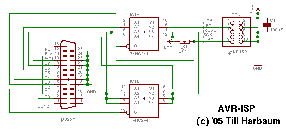

Programming interface (ISP)
The firmware is uploaded using the standard 10 pin AVR ISP connector (SV1). A separate programming cable is required to load the firmware onto the LCD2USB. A simple do-it-yourself cable will be sufficient. A PC software like e.g. Ponyprog or UISP will then be used to upload the firware via this cable to the AVR on the LCD2USB device.

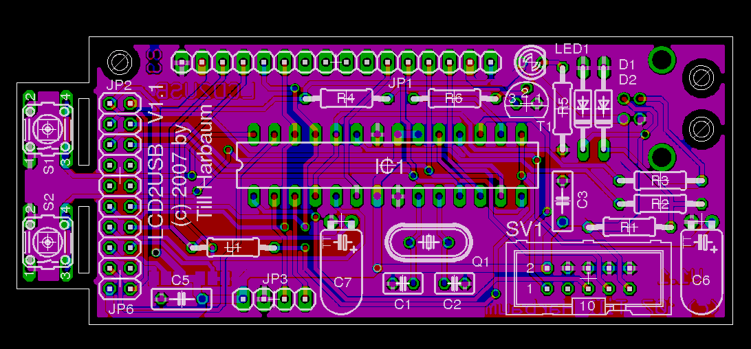

Schematics and PCB layout
Click to enlarge
Click to enlarge

Part list remarks
The crystal should be in the small HC49U package. You can use a crystal in HC18 package, but you'd then have to mount it from the rear pcb side.
C1 and C2 should have their pins 2.54mm (1/10 inch) apart, C3 and C5 have their pins 5.08mm (2/10 inch) apart.
Although T1 is labeled BC547C, a BC547A or BC547B will be fine as well.
The cathode of LED1 faces the R5 label. The long leg of the LED is thus close to JP1.
Resistor R4 is the current limiting resistor for backlighting. The 47 ohm in the part list is a useful and secure value for some LCDs with low power LED backlighting. Some displays already include the current limiting resistor and/or require a higher current. The symptom usually is a very dark or even barely visible backlighting with R4 at 47 ohms. You can lower the value of R4 in order to increase the backlight current and thus the brightness. Please consult the datasheet of your display for its backlight power requirements and in order to select the correct current limiting resistors. The BC547 transistor T1 may not be sufficient for displays requiring backlight currents > 100mA. A user has reported success by replacing T1 with a BS170 MOSFET and driving the backlight with 240mA.
