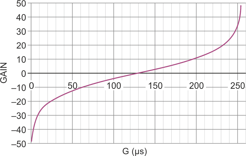

as graphed linearly in Figure 2 and logarithmically in Figure 3.

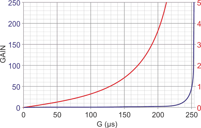

| Figure 2. | The linear gain plot (Red = 0 to 5 and Blue = 0 to 255). |
The positive (VDD) and negative (VEE) power rails are non-critical and noise-insensitive but ideally should be at least roughly symmetrical and will typically be +5 V and –5 V, respectively. Total current draw is less than 2 mA. Both C1 and C3 should be low-leakage types, polystyrene is suggested. Response time to an input or gain set step is somewhat gain dependent but is typically ~2 ms. Note that the R1C1 time constant is ~4T = 1 ms. Neither is exactly what you’d call lightning fast, but we are after all talking about PWM!
| Figure 3. | The log gain plot. |
