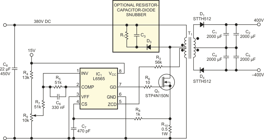

Figure 1 shows the power stage of a charger using the ST L6565. It achieves the BCM using a second primary winding on T1 that feeds the transformer-sensing input at the ZCD pin of the L6565. The voltage of this winding is a scaled-down replica of the drain-to-source voltage of power MOSFET Q1. When the circuit interrupts the secondary current – indicating full demagnetization of T1 – it detects the minimum of the first valley of ringing, and the L6565 turns on the MOSFET. This action eliminates the idling and zero-phase-time intervals, thus establishing BCM. The elimination of the zero-phase-time intervals greatly reduces the charging time of the storage capacitors.

At the beginning of the charging sequence, the output voltage is low because of the large capacitance values. The secondary current decreases slowly. The reflected voltage on the primary side is too low to trigger the ZCD pin of the L6565. Thus, the L6565’s initial starting timer sets the switching frequency to 2.5 kHz at the start of charging. The output voltage across the storage capacitors increases to a point at which the switching frequency becomes variable because of the demagnetization of the transformer core. Figure 2 shows that, as soon as the secondary current (Channel 2) becomes 0 A, the power MOSFET turns on, and the drain-to-source voltage decreases (Channel 1). At that time, the primary current again increases (Channel 4). At the output voltage close to full charge, the switching frequency is approximately 100 kHz. Figure 3 shows the total voltage of 750 V across C1, C2, C4, and C5 within a 3-second charging time.
