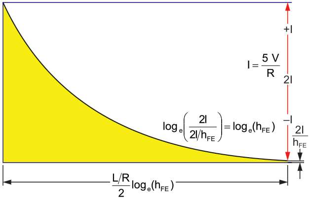

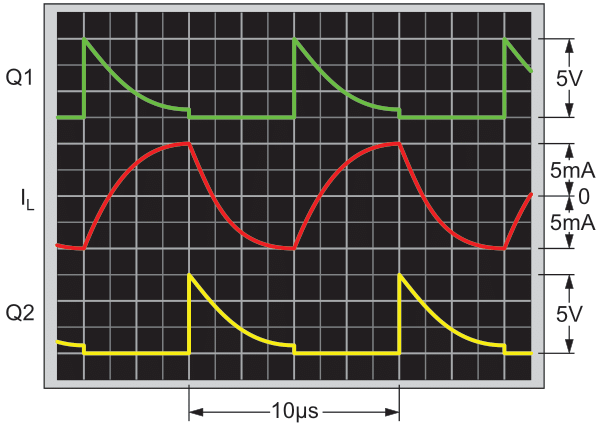

Figure 2 and Figure 3 show in better detail where the timing relationships come from. Using the Figure 1 resistor and inductor values,

Inductor current wave shape during one ~5 µs oscillation half-cycle.
Figure 2. Inductor current wave shape during one ~5 µs oscillation half-cycle.

Oscillator waveforms: IL and Q1, Q2 output signals.
Figure 3. Oscillator waveforms: IL and Q1, Q2 output signals.
