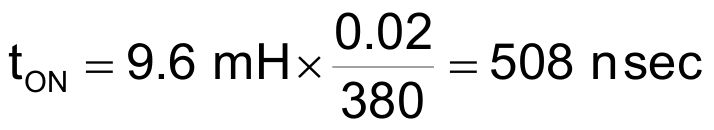

If you select a ripple current of 20 mA peak-to-peak at 380 V dc, then
From this value, you can check the minimum on-time using the equation:
above the minimum limit.
