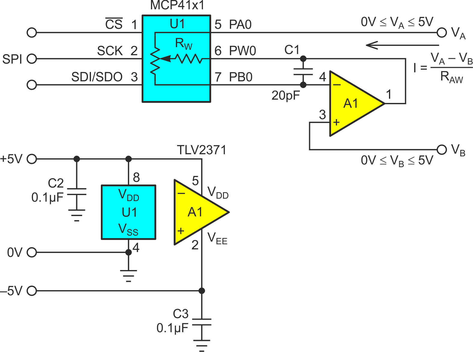

Suffice to say, cancellation of RW would make worthwhile improvements to DPOT performance in many precision applications. Figure 1’s topology does this. Here’s how it works.
| Figure 1. | Op-amp A1 actively drives digital pot U1 wiper terminal PW0 to force VPBO = VB while drawing negligible current through resistance RWB, thus cancelling the effect of RW. |
The connections of A1’s (+) input to reference voltage VB (typically, but not necessarily, ground), (-) input to U1’s PB0 pin, and its output to U1’s PW0 pin establishes a feedback loop that forces VPBO = VB independently of RW. This, as advertized, wipes out RW effects.
Compensation capacitor C1 probably isn’t absolutely necessary for the part selection shown in Figure 1 for A1 and U1, but if a faster A1 amplifier or a higher RAB resistance DPOT where chosen, it probably would be.
