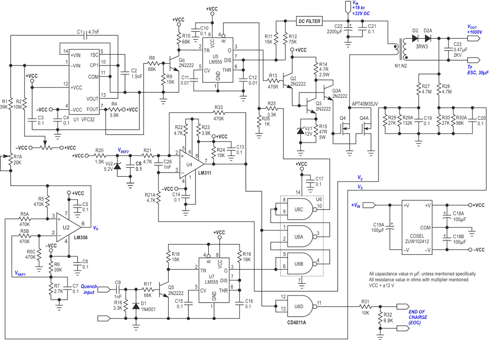

The circuit shown in Figure 1 is that of a flyback converter-based capacitor charging unit for a Q-switched Nd:YAG laser operating at 20 Hz. The design charges an energy storage capacitor (ESC) of 30 µF with the desired energy of 15 joules in less than 50 ms so as to ensure operation at 20 Hz.
А flyback converter-based capacitor charging unit.
Figure 1. А flyback converter-based capacitor charging unit.
The circuit operates in an externally driven flyback configuration. Energy is stored during the on-time of the switching MOSFET and transferred to the energy storage capacitor during the time when it is switched to off-state. Each time the energy is transferred to the secondary circuit, the output capacitor charges by a certain voltage step. The magnitude of this step decreases with the buildup of voltage across the capacitor. The reduction of off-time of the switching device follows the same pattern as the buildup of voltage across the capacitor. The voltage across the energy storage capacitor is sensed and a control voltage VS is generated. This voltage is fed to a subtractor U2 that subtracts a negative reference voltage VREF1 from the control voltage. The output of subtractor is VR = VS – VREF1, which is fed to voltage-to-frequency converter (VFC) U1; hence the operating frequency is changed linearly with the voltage across the capacitor.
Initially, when the ESC is uncharged, the output voltage is zero and VS = VS(MIN) = 0 V. At the output of U2, we have small positive voltage (VR(MIN) or –VREF1). This voltage determines the initial period at the VFC output. This output goes to monostable multivibrator U5 to achieve a fixed on-time. As the ESC voltage builds, the control voltage to the VFC converter increases, which reduces the off-time. A voltage sense loop compares VC – a fraction of the output voltage – with reference voltage VREF2 to generate the reset pulse for the monostable circuit and consequently achieve the desired output voltage.
The unit also has a feature of quenching the converter that prevents “afterglow” of the flash lamp. For quenching of the flash lamp, the charging of the ESC must be disabled for a few milliseconds at the instant of the flash lamp firing command. This is achieved by holding off U5 during this period. The holdoff is generated by triggering a second monostable, U7, by the firing command pulse. The EOC output indicates that the charging process has been completed.

The transformer was designed to deliver an output power of 300 W (15 J of energy at 20 Hz rate), and a conversion efficiency of 80% was assumed.
Core Type EE 4215 (Make Cosmo Ferrite Limited)
Effective magnetic path length 97 mm
Effective cross-sectional area 181 mm2
Maximum saturable flux density 390 mT
Operating maximum flux density value
taken for the design to avoid core saturation
300 mT
Initial Permeability 3,000
Primary turns, NP 11
Secondary turns, NS 275
Primary Inductance, LP 10 µH
Peak primary current, IP 60 A
Constant ON-time of the switching MOSFET 25 µs
