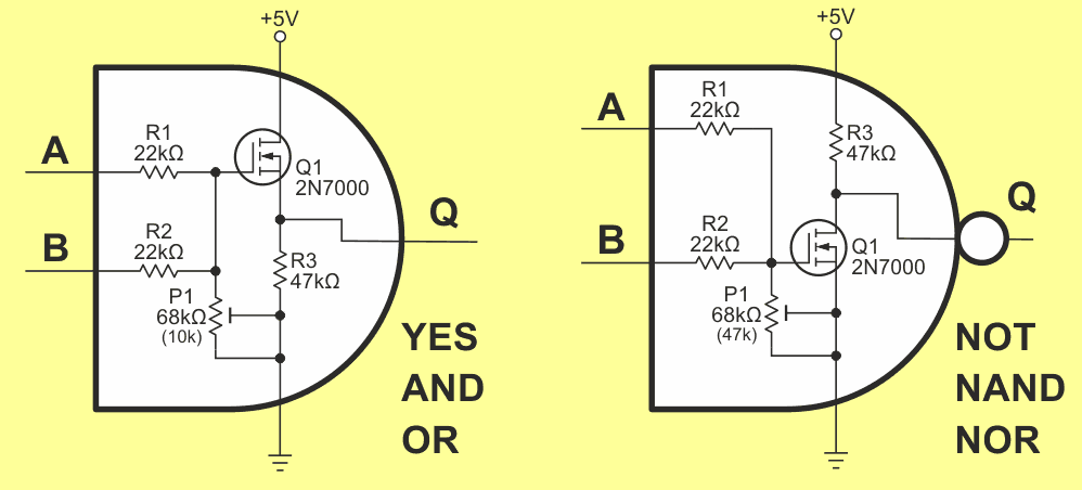

Figure 1 illustrates how YES, NOT, AND, OR, NAND, and NOR gates are implemented in RFL using a 2N7000 N-channel MOSFET and a 5 V supply. (Note that the XOR and XNOR functions have been omitted here, due to their complexity.)
Basic logic functions implemented in RFL.
Figure 1. Basic logic functions implemented in RFL.
Given that the gate threshold voltage of a 2N7000 MOSFET lies around 1.9 V, the same circuit (Figure 1, left) covers:
  • a YES gate (A and B combined, with P1 adjusted to around 30 kΩ)
  • an AND gate (P1 adjusted to around 30 kΩ) and
  • an OR gate (P1 adjusted to around 160 kΩ).

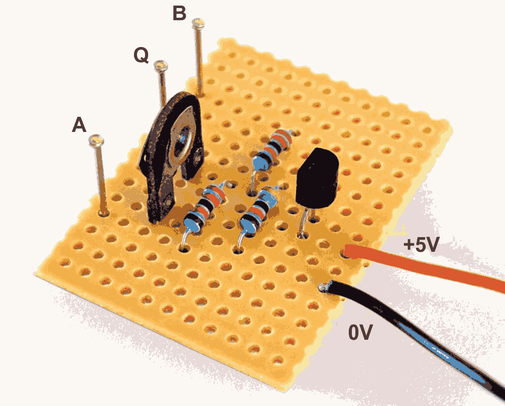

The inverted circuit (Figure 1, right) similarly covers NOT, NAND, and NOR gates. Fixed resistors may be used in place of P1 if desired. Figure 2 shows a breadboard of the left circuit shown in Figure 1.
A breadboard of the left circuit in Figure 1, which implements YES, AND, and OR gates.
Figure 2. A breadboard of the left circuit in Figure 1, which
The Table 1 shows illustrative (not precise) potentials at FET Q1’s gate, and the outputs at terminal Q, whether HIGH or LOW. Note that, if gates are cascaded, input and output impedances may need to be adjusted to give the desired output voltage and current.
Table 1. Illustrative (not precise) potentials at FET Q1’s gate,
P1 10k Q1 GATE LOGIC
A B
+5V +5V 2.4V HIGH
+5V 0V 1.2V LOW
+5V FL. 1.6V LOW
0V +5V 1.2V LOW
0V 0V 0V LOW
0V FL. 0V LOW
FL. +5V 1.6V LOW
FL. 0V 0V LOW
FL. FL. 0V LOW
P1 47k Q1 GATE LOGIC
A B
+5V +5V 4.2V HIGH
+5V 0V 2.1V HIGH
+5V FL. 3.5V HIGH
0V +5V 2.1V HIGH
0V 0V 0V LOW
0V FL. 0V LOW
FL. +5V 3.5V HIGH
FL. 0V 0V LOW
FL. FL. 0V LOW
FL. = FLOATING
GATE THRESHOLD VOLTAGE 1.9 V
