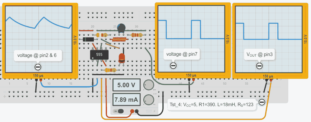

At power-on, the inductor voltage (VL) spikes up and exceeds the 555’s trigger voltage of 2VCC/3. Output (VO) at pin 3 goes low and the discharge transistor at pin 7 turns on which provides a low-resistance path to ground. Inductor current (IL) begins to rise as VL and the voltage at pin 2 (V2) and pin 6 (V6) all fall exponentially.
When V6 gets below the 555’s threshold voltage of VCC/3, VO goes high, and the discharge transistor turns off. Because IL was interrupted, the inductor’s voltage reverses which forward-biases the flywheel diode (D). Pin 7 gets clamped to a diode forward voltage above VCC. Both IL and VL start to fall towards zero while V2 climbs toward VCC.
When V2 crosses 2VCC/3 again, VO goes low, the discharge transistor turns on, and the train of regular high and low output pulses ensues. The expected waveforms are shown in Figure 2.
![The simulated waveforms using Tinkercad (setting: 15 µs/div).](https://www.rlocman.ru/i/Image/2024/01/24/Fig_2_Eng.gif) |
Figure 2. |
The simulated waveforms using Tinkercad (setting: 15 µs/div). |

![Experimental set-up with the Digilent Analog Discovery 3 connected to the +5 V to the experimental circuit.](https://www.rlocman.ru/i/Image/2024/01/24/Fig_3.jpg) |
Figure 3. |
connected to the +5 V to the experimental circuit. |
Finally, we connected to our laptop, a USB-powered test and measurement device – the Digilent Analog Discovery 3 (AD3) – to supply +5 V to the experimental circuit (Figure 3) and observe the waveforms from pins 2 and 6, and 3 of the IC (Figure 4). We tested 8 chips from a bin of assorted 555s and noticed that while TH was consistent, the TL values annoyingly lacked precision. Nonetheless when we compared the AD3 Measurements with the Predicted values in Table 3, we saw that Equation 1 fairly modeled the output of the new multivibrator.
![Waveforms of V2, V6, and VO, and measurements for VO.](https://www.rlocman.ru/i/Image/2024/01/24/Fig_4.gif) |
Figure 4. |
Waveforms of V2, V6, and VO, and measurements for VO. |
