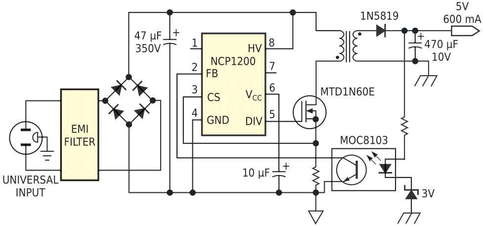

When a switch-mode power-supply controller, such as NCP1200, operates at a high ambient temperature, you should protect the entire power supply against lethal thermal runaway. The NCP1200 operates directly from the power mains without an auxiliary winding; therefore, the die in the IC dissipates power (Figure 1).
A controller IC implements a low parts-count offline power supply.
Figure 1. A controller IC implements a low parts-count offline power supply.
