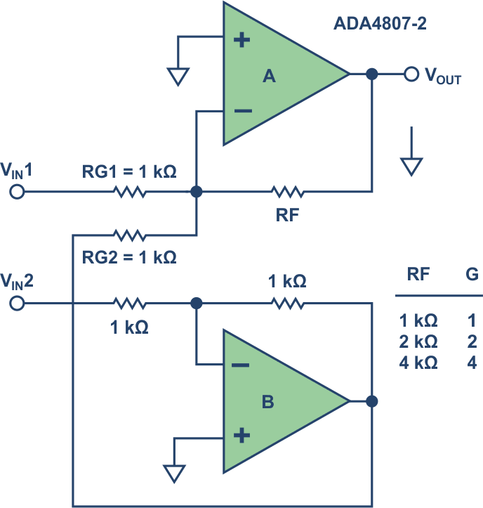

| Figure 1. | The differential input, single-ended output amplifier. |
A simple solution is to use dual precision amplifiers with a resistive gain network, as shown in Figure 1. This circuit shows a simple way of converting a differential input to a single-ended output with adjustable gain. The gain (G) of the system can be set by Equation 1:
(1) |
Where gain = RF/1 kΩ and (VIN1 – VIN2) is the differential input voltage
Generally, this technique provides a more stable reading when EMI or RFI is present and, therefore, it is recommended when noise is a problem. This is especially true when measuring thermocouple, strain gage, and bridge type pressure sensor inputs, since they produce very small signals in a noisy environment.
This circuit can offer a performance improvement over single-ended inputs by not only measuring the difference in voltage between the positive and negative terminals of the sensor, but also providing common-mode rejection with some system gain. Furthermore, the sensor ground can be different from the analog ground. An output voltage referenced to ground is important in many applications. The accuracy of the system depends on the tolerance of the network resistors.
The circuit can convert a differential input to a single-ended output with an adjustable gain. The gain of the system can be set by the ratio of RF and RG1 with the assumption that RG2 = RG1 and amplifier B has a gain of –1.
For example, the ADA4807-2, a 180 MHz dual amplifier, can be built as an inverting amplifier for this application and this circuit provides lower noise. With a low quiescent current of 1000 μA per amplifier, the circuit is ideal for low power, high resolution data conversion systems.
The input common mode can go beyond the supply voltages. The output is rail to rail, which makes it useful in the presence of a large common-mode signal or a large output voltage applications. For example, the data acquisition board has an ADC that accepts a single-ended input of 0 V to 5 V. However, the signal source happens to be differential voltage generated from a sensor bridge where one terminal swings positive while the other swings negative in response to pressure in the presence of common noise.
