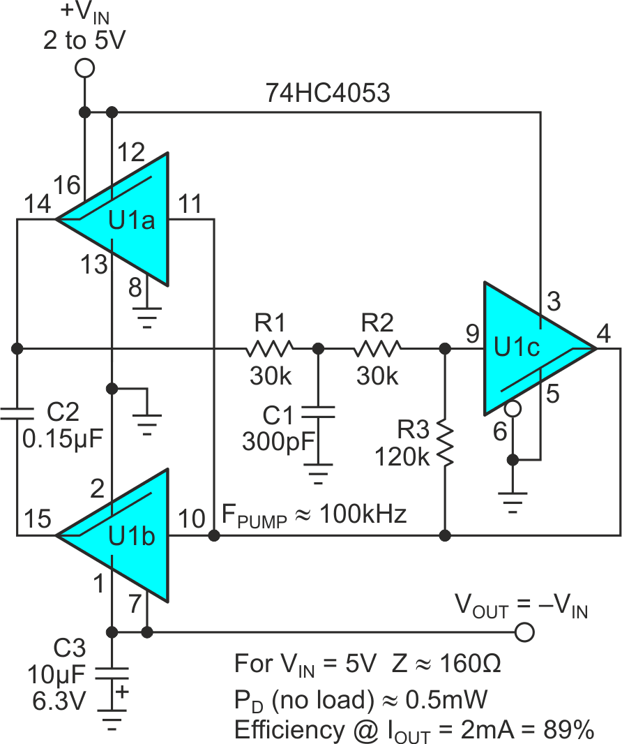

It’s interesting, useful, and fun that basic electronic topologies often turn out to have utility in multiple and surprisingly different applications. Figure 1 shows an example of such a circuit. It’s a charge pump voltage inverter circuit originally published in “A simple, accurate, and efficient charge pump voltage inverter for $1” (Ref. 1).
| Figure 1. | Basic voltage inverter circuit scaled for efficiency at 100 kHz and several milliamps of current output. |
Configured thusly for the voltage inverter application, the pump is simple and cheap. It draws only about 1 µA per kHz (unloaded) from the 5-V rail.
