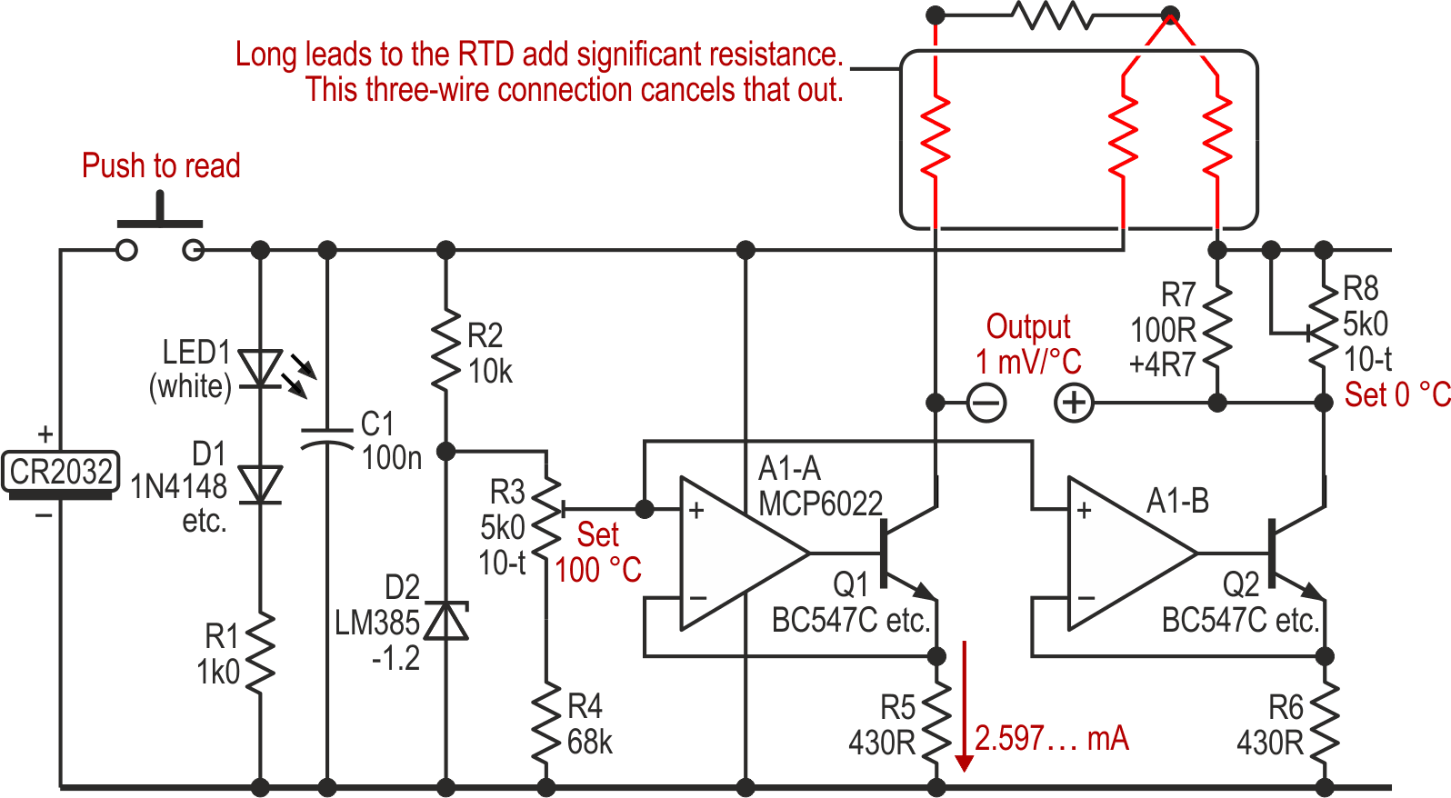

Figure 3 shows how to do this for real.
| Figure 3. | A practical circuit capable of delivering exactly 1 mV/°C. |
A1-A/Q1/R5 and A1-B/Q2/R6 form the pair of constant-current sources – or rather sinks, since we have turned the circuit upside down. The common reference for each comes from D2, a precision 1.24-V reference, potted down to about 1.12 V, which is of course the (theoretical) voltage that 2.597…mA produces across 430 Ω. The differential voltage across the outputs is now just what we want: 0 V at 0 °C and 100 mV at 100 °C. (In a perfectly-designed world, where TCRs stayed constant from absolute zero to 2044 K – the melting point of platinum – we’d be using a current of 2.7315 mA.)
The other odds and ends to the left of the schematic are boring practicalities: a CR2032 3-V coin cell, a push-to-read switch, as well as a series diode and resistor feeding a white LED which just dims out at the minimum usable battery voltage of about 2.7 V, where the second decimal place starts to wander. (That power/low battery indication is adequate for lab use, if rather basic.) Consumption measured around 8 mA.
Calibration is necessary but easy. To set the 0 °C point, immerse the RTD in crushed, melting ice and adjust R8 for zero output voltage. Then hang it in the steam above the water in a kettle just off the boil and trim R5 for an output of 100.0 mV. That’s it!

Firstly, there are the connections to the RTD, with their own resistances adding to that of the sensor. This unit only needed a meter or so of cable as it was purely for lab use. The length of 18 AWG (~1 mm2) wire has a loop resistance of ~90 mΩ, giving an error of ~0.02 °C: ignorable, as is the second-order effect of the temperature coefficient of resistance (TCR) of the copper leads themselves. However, many RTD assemblies (as opposed to basic sensor elements) come with three wires, allowing a configuration where this error completely cancels out, assuming that all wires have the same resistance, as shown in Figure 4.
| Figure 4. | Three-wire connection to the RTD allows cancellation of the cable’s resistance. |

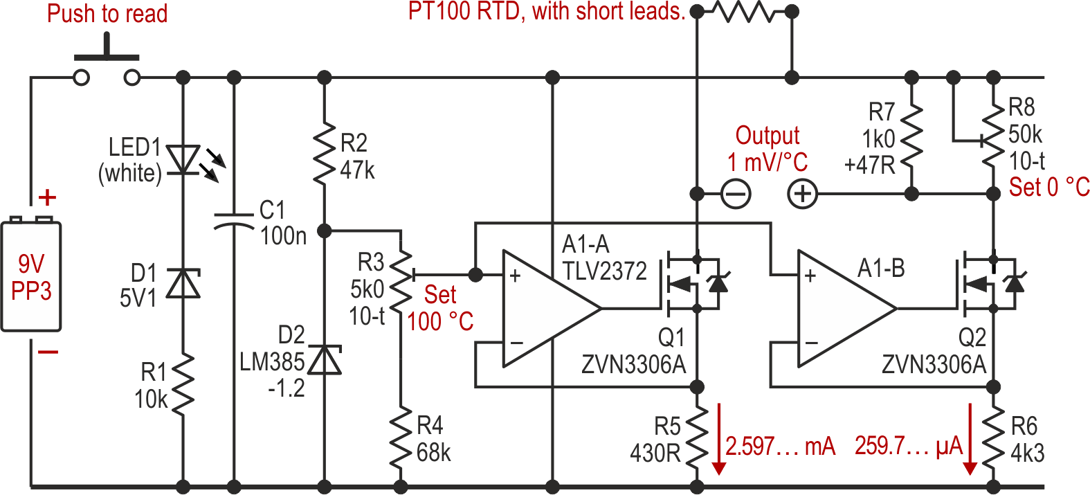

Those MOSFETs for Q1/2 that we met earlier but rejected: with a higher supply voltage and a different op-amp, they can still be used. A TLV2372 (RRIO) would be ideal, but an LM358 works well, as it can sense down to ground and (just) drive up to the positive rail, with input offset currents which are adequately low and fairly constant. In the test, using ZVN3306A MOSFETs, that variant gave stable results with a supply ranging from 4.6 to 30 V. (R2 was increased for the higher voltages.)
Unequal bridge currents
So far, the currents in the two legs of the bridge have been equal, but they need not be, as the reference current defining the 0 °C point can be much lower. Increasing R6/7/8 by ten times or so saves a couple of milliamps with no practical downsides that I can spot, especially when using the MOSFETs. The leads to the sensor must then be short, because the lead resistance compensation scheme shown in Figure 4 only works with equal currents. My Mark 2 version, shown in Figure 5, uses this 10:1 current ratio along with other changes to suit the 9-V supply. It too works fine, drawing about 6 mA.
| Figure 5. | A higher battery voltage allows the use of MOSFETs in the current sinks, while a lower current in the reference arm of the bridge saves some supply current. |
