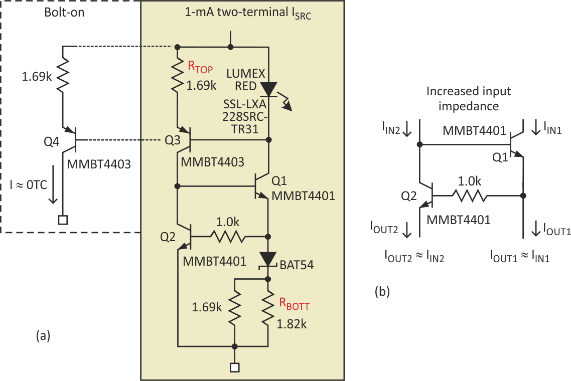

A two-terminal current source using the basic circuit of Figure 1a can be enhanced by adding on an independent subcircuit that uses degeneration of a PNP transistor to achieve zero temperature coefficient (tempco or TC). This low-cost design is the result of collecting data on many semiconductor devices over a 15+ year period and frequent reviews of the data. ("Degeneration" is the insertion a resistor in series with the emitter, which decreases the gain of the amplifier but improves attributes such as linearity and input impedance.)

Audio-design engineers have known for years that ON Semiconductor’s MMBT4401 and MMBT4403 feature very low base resistance (RB) and thermal noise, and are very good for current-source and mirror circuits. The MMBT4401 and MMBT4403 are complementary devices related to dc biasing and tempco. Complementary devices make it easier to understand the zero tempco design as a “glue” circuit needs to pass the current from the PNP device Q3 of its mirror to Q2. The base-to-emitter voltages VBE will be approximately equal in those two transistors.

Figure 1b is the “glue” circuit using two each of MMBT4401 NPN devices and 1.0-kΩ resistor. It connects a top current mirror and a bottom current mirror. The two key design equations for the add-on circuit are:
IE(Q2) ≈ IIN2, therefore:
IOUT1 ≈ IC(Q1), therefore:

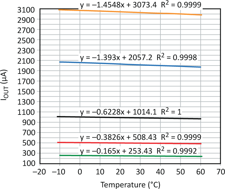

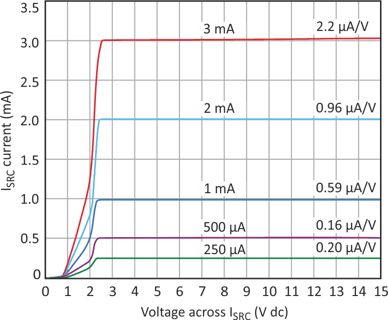

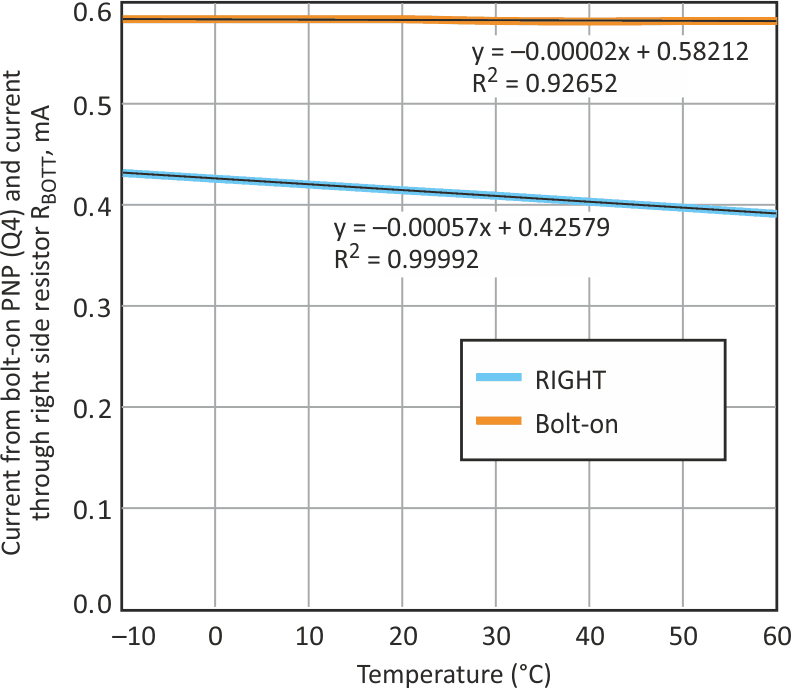

Figure 2 shows the current-source values and their change with temperature, while the steady-state performance over input voltage and the minimum operating conditions are shown in Figure 3. The tempco of the bolt-on circuit (Figure 4) compares favorably with the REF200, a commercially available, precision, dual-current source/current sink. That device has a temperature coefficient of ±25 ppm/°C on its fixed 100-μA current source.

| Figure 4. | The plot indicates ~0 tempco in the bolt-on MMT4403 (Q4) PNP transistor to the 1-mA ISRC. The red plot line for the bolt-on shows a TC of –35 ppm/°C. |
