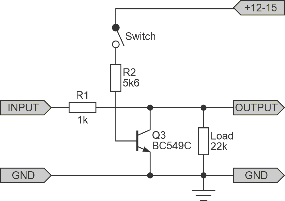

The most important part of the circuit is the complete isolation of the base (via R2) when the circuit is off (Figure 1). Even a tiny leakage resistance will cause distortion. However, it's most unlikely that even Veroboard or similar will have enough leakage to cause a problem if you are careful with wiring. Stray capacitance isn't a major issue provided it's less than around 100 pF. That's a surprisingly high capacitance to achieve just from normal components and wiring techniques.

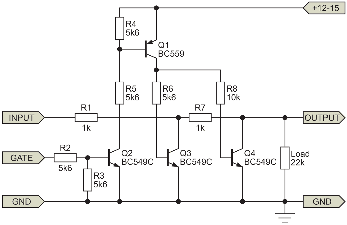

If you need higher attenuation, simply use two transistors, separated by another resistance (Figure 2). Unlike a relay, this signal voltage clamp must have some resistance in series, because the transistors are not capable of shorting the low impedance output from typical preamps without a lot of 'break-through' signal, which will be highly distorted. A single clamping transistor will give an attenuation of around 46 dB, but doubling up as shown below increases that to about 90 dB – at least in theory. You can certainly expect that the end result will be a well and truly muted signal.
| Figure 2. | Dual transistor AC voltage clamp. |
The control voltage supply (+12 to +15 V) doesn't need to be anything special, and will normally be the supply rail for the preamp or other device that needs a muting circuit. If it has a bit of ripple or noise some of it may be transferred to the output when the clamp transistor(s) are turned on, but any noise will be highly attenuated so it should normally be completely inaudible. Switching is virtually instantaneous – the circuit does not provide any gradual or 'soft' switching ability. The signal at the output is either on or off – there is no intermediate state. Any attempt to slow down the switching will cause serious distortion during the transition, and if not done properly may cause distortion even when the switches are supposed to be off.

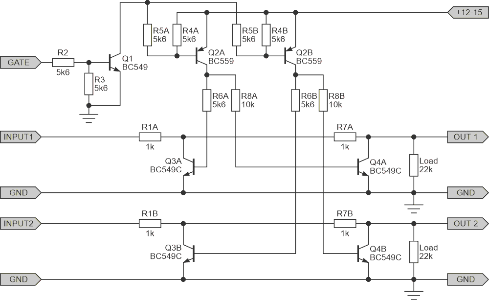

The full circuit for two channels is shown in Figure 3. It uses the same control voltage from Q1. There are separate control voltage switches (Q2A/B), because they prevent any possible cross-coupling between channels. A single transistor can be used and R6A/B and R8A/B simply joined, but you may get some distorted crosstalk under some conditions. For the small cost of a transistor and couple of resistors, it's not worth cutting corners. All resistors can be standard 5% carbon film types – there is no need for precision. For lowest possible noise, those resistors in the signal path (R1A/B and R7A/B) can be metal film types.
| Figure 3. | Complete 2-channel AC voltage clamp. |
To mute the signal, it is only necessary to apply a positive voltage to the 'Gate' terminal. We need a base current of at least 0.5 mA into Q1 to ensure that Q2A/B turn on fully, so R2 is nominally 5k6 (assuming that the switching voltage is 5 V DC or more). If the voltage is lower, then R2 should be reduced in value. For example, with a 3.3 V supply as used by some micro-controllers, R2 should be around 2.2k. The value can be increased for higher voltages, but the value shown is quite safe at up to 15 V.
If your auxiliary circuitry normally pulls its output to earth to activate muting (for example an open-collector output from a micro-controller or other logic), then Q1 can be omitted – the resistors (R5A and R5B) must be retained! Make sure that the source allows its outputs to be pulled above the logic supply voltage, or the circuit will mute permanently.
Remember that the collectors of Q2A/B must connect to nothing else in the circuit – they have to be floating. You will see that base-emitter resistors aren't used on Q3A/B or Q4A/B, because adding them will cause gross distortion at any level greater than 0.6 V peak. Even as high as 1M will increase the distortion by a factor of at least 10!
