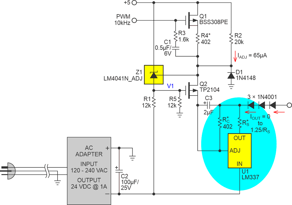

RC > 100RS allows control of current of IOUT with only milliamps of IC. Figure 3 shows the idea fleshed out into a complete PWM-controlled 18 V, 1 A grounded-load negative current source.
An 18 V, 1 A, PWM-programmed grounded load negative current source with a novel LM337 topology.
Figure 3. An 18 V, 1 A, PWM-programmed grounded load negative current source with a novel LM337 topology. With this
topology, accuracy is insensitive to supply rail tolerance. The asterisked resistors are 1% or better and RS = 1.25 Ω.

The resulting 5-Vpp PWM switching by Q1 creates a variable resistance averaged by C1 to R4/D, where D = the 0 to 1 PWM duty factor. Thus, at Z1’s Adj point:
The second-order PWM ripple filtering gives a respectable 8-bit settling time of 6 ms with FPWM = 10 kHz.
Z1 servos the V1 gate drive of Q2 to hold the FET’s source at its precision 1.24-V reference and then level shift the resulting IC to track U1’s ADJ pin. Also summed with IC is IADJ bias compensation (1.24 V/20k = 62 µA) provided by R2.
This term zeros out U1’s typical IADJ and cuts its max 100 µA error by 60%. Meanwhile, D1 insures that IOUT is forced to zero when 5 V drops by saturating Q2 and making IC large enough to turn U1 completely off, thus protecting the load.
About the 1N4001 daisy chain: There’s a possibility of IOUT > 0 at IC = max and a resulting reverse bias of the load; some loads might not tolerate this. The 1N4001s block that, and also provide bias for the power-down cutoff of IOUT when +5-V rail shuts down.
Note that the accuracy of ICRC = VADJ is assured by the match of the RC resistors and precision of the Z1 and U1 internal references. It’s therefore independent of the tolerance of the +5-V rail, although it should be accurate to ±5% for best PWM ripple suppression. IOUT is linear with PWM duty factor D = 0 to 1:
If RS = 1.25 Ω, then IOUT(MAX) = 1 A.
Note that U1 may have to dissipate as much as 23 W if IOUT(MAX) = 1 A and the load voltage is low. Moral of the story: Be generous with the heatsink area! Also, RS should be rated for a wattage of 1.252/RS.

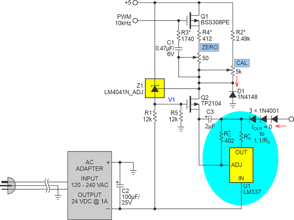

Figure 4 shows modifications to facilitate wiping out component tolerances including those of U1 and Z1 references and all resistors.
Модификации для облегчения устранения влияния допусков номиналов компонентов, включая источники опорных напряжений U1 и Z1, а также все резисторы. Обратите внимание, что RS = 1.1 Ом.
Figure 4. Modifications to facilitate wiping out component tolerances including those of U1 and Z1 references and all
resistors. Note that RS = 1.1 ohm.
The one pass calibration sequence is:
  1. Set D = 100%
  2. Adjust CAL pot for 1.000 amp output current
  3. Set D = 0%
  4. Adjust ZERO pot for zero output current.
Done. IOUT = 1.1 D/RS.
