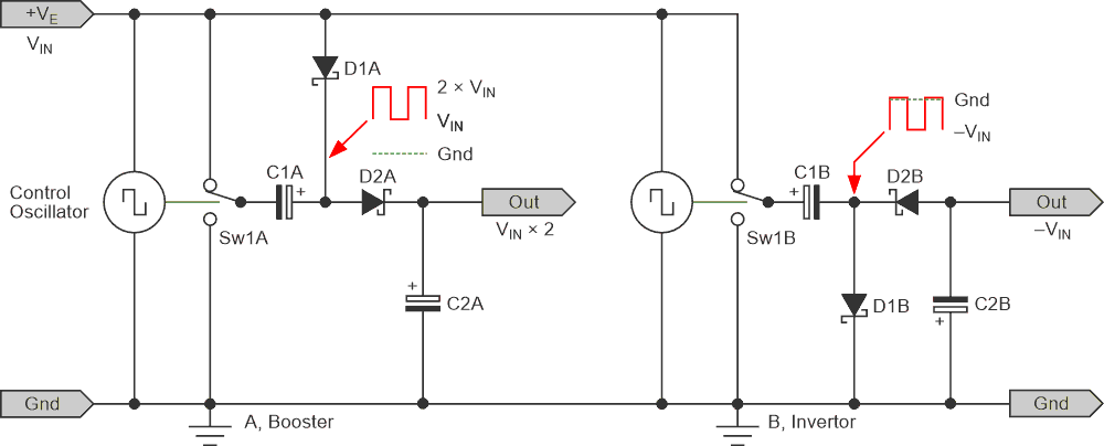

The principle of a charge-pump is pretty straightforward. A switching system connects the output alternately between the positive supply and ground, ideally with no voltage drops due to transistors or series resistance. Since ICs all use transistor switches, there are inevitable losses. Dedicated charge-pump ICs minimise these losses, but they can't be eliminated. The operation of a booster is quite different from that for a voltage inverter, but they tend to be lumped together in most descriptions. Despite initial appearances, the voltage across C1 (either circuit) barely changes once the initial set-up conditions are established. There is ripple current though, and it's roughly twice the output current.
The 'ideal' switches are toggled by the control oscillator, and when one contact is open the other is closed. We'll look at the boost circuit first (Figure 1, left). When the switch is closed to ground, C1A charges via D1A from the supply to ground. When the switch changes state, the charge on C1A boosts the positive end to twice the input voltage (2 × VIN). This doubled voltage is transferred to C2A via D2A. If there were no voltage drops across the diodes, the output voltage would be exactly double the input (DC) voltage. The output cap (C2A) must have a voltage rating to suit the maximum output. It's also possible to connect the negative of C2A to +VE – it's rarely seen, but works perfectly well, and means the cap's voltage rating doesn't need to be 2 × +VE.
The negative voltage generator circuit works very differently (Figure 1, right). The connection of C1B and D1B forms a simple voltage clamp, with the input voltage varying from zero to +VE. Back in the days of analogue television, this circuit was commonly known as a 'DC restorer'. When the switch is connected to +VE, C1B charges via D1B. When the switch connects to ground, the positive of C1B is grounded, so the negative terminal has –VE on it, which is coupled to C2B via D2B so C2B now also has –VE across it. This is the negative supply. The rectifier is half-wave. C2B is charged at the switching frequency.

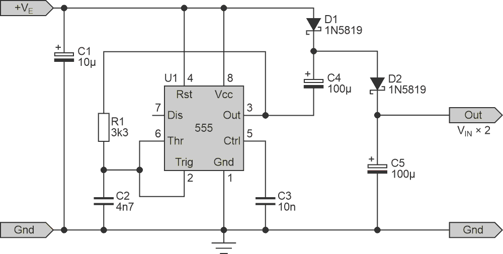

The output ripple is determined by the switching speed, the value of C1 and C2, and the load current (Figure 2). In general, C1 and C2 are usually made equal, but it's often quite aright if C1 is a lower value. For example, C1 might be 33 μF, while C2 could be 100 μF. If they aren't equal the output voltage is reduced a little, and ripple is increased. 100 μF is a good 'general purpose' value, but if the required current is less than 10 mA, the caps can be reduced. I don't recommend anything less than 33 μF though, because the 555 timer doesn't like high frequencies. Operation at (or around) 30 kHz is a reasonable compromise.
Boost circuit: 12 V in, 24 V out (nominal).
Figure 2. Boost circuit: 12 V in, 24 V out (nominal).
With the 'ideal' circuits shown above, the output ripple is about 5.4 mV p-p for the doubler (100 μF, 30 kHz) and 4.7 mV p-p for the inverter (same values). This is with an output current of (very roughly) 10 mA for both. If the capacitance is increased by a factor of three, the ripple is reduced by the same amount. Likewise, if the oscillator frequency is halved, the ripple is doubled.
Neither circuit is designed for high current, and in general it should be no more than 10 mA or so. The 555 timer is configured as a 'minimal component count' oscillator, saving a resistor compared to the 'conventional' astable (no stable state) oscillator. The frequency is nominally about 32 kHz to ensure that it's out of hearing range. You can get around 20 mA if you're willing to lose 4 V (12 V in, –12 V out or 12 V in, 24 V out). The actual outputs will be around –8 V or +20 V (inverting, boosting respectively).

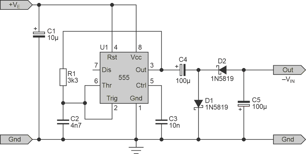

The inverting circuit in Figure 3 (if 100% efficient) would provide a –12 V supply. The limitation is the 555 itself, as it can't source or sink enough current to get the full 0-12 V output swing under load. The maximum is around 10 V, with a minimum of 750 mV (at an output current of +26 mA and –36 mA). The diodes also reduce the available voltage, because even Schottky diodes have a forward voltage. Those shown are recommended as they are designed for relatively high current (1 A), although they are 40 V types and have a higher forward voltage than 1N5157 (20 V) and 1N5158 (30 V).
