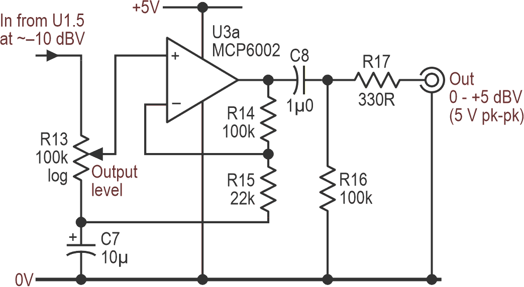

Swapping the capacitors C1 and C2 for 3n3 and 330n parts gave the expected performance on higher and lower ranges, though distortion was a few dB higher on the low range, and the level was less well-controlled at the highest frequencies. All that’s needed to turn this into a useful kit is an output stage, for which the fairly conventional circuit of Figure 3 works well.
| Figure 3. | A simple output stage can deliver up to about +5 dBV, which is the rail-to-rail swing for a 5 V supply. |
The extra stage adds almost no distortion, and leaves a spare op-amp (U3b) which could be used to invert the signal from U3a to provide antiphase outputs. One final spectrum, taken with the oscillator set for –10 dBV and the output for a swing of nearly 5 V, is in Figure 4. That confirms an overall THD of –73 dB, or 0.022%. Hardly earth-shattering, but still quite decent.
