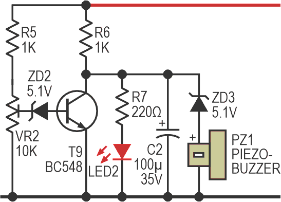

The low-battery indication circuit consists of transistor T9, preset VR2, Zener diode ZD2, resistors R5, R6, and R7, LED2, and capacitor C2 (Figure 2). The 12 V supply voltage from BAT1 is applied to the low-battery indicator circuit with a full load (not more than 1000 watts) connected to the inverter output.
Low battery indicator circuit.
Figure 2. Low battery indicator circuit.
The voltage across the load is 230 V AC. At this instant, adjust preset VR2 such that Zener diode ZD2 and transistor T9 conduct to drop the collector voltage to 0.7 volt keeping LED2 ‘off.’
If the supply voltage goes below 10.5 volts, the voltage across the load decreases from 230 V AC to 210 V AC.
At this instant, Zener diode ZD2 and transistor T9 do not conduct, and hence the collector voltage increases to about 10.5 volts and LED2 glows to indicate the low voltage of the battery.
At the same time, piezo buzzer PZ1 produces an audio tone indicating a low battery.

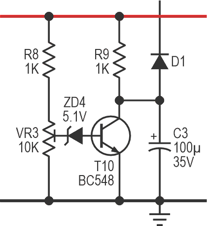

If the battery is discharged to zero volts repeatedly, the battery life will decrease. The low-battery cut-off circuit consists of transistor T10, preset VR3, Zener diode ZD4, resistors R8 and R9, capacitor C3, and diode D1 (Figure 3).
Low-battery cut-off circuit.
Figure 3. Low-battery cut-off circuit.
Adjust preset VR3 such that when the voltage across the load is above 200 volts, Zener diode ZD4 and transistor T10 conduct. The collector voltage of T10 is about 0.7 volts in this case and hence the SCR (SCR1) will not conduct.
But if the voltage across the load goes below 200 volts, Zener diode ZD4 and transistor T10 will not conduct and the collector voltage of T10 will increase, causing the SCR to conduct.
Once the SCR conducts, the supply voltage to IC1 (CD4047) will be 0.7 volts, due to which IC1 will be unable to produce the voltage pulses at output pins 10 and 11 and the inverter will turn off automatically. During this state, the SCR remains conducted.
The low cut-off of the inverter can be set at the load voltage of 170 volts for the tube light, fan, etc. So the tube light and fan will not be switched off until the voltage goes below 170 volts.

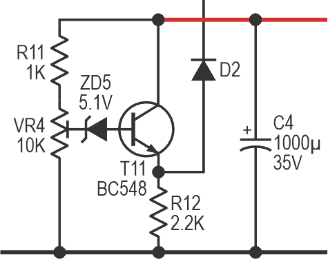

If there is no load connected to the output of the inverter, the output voltage is 270 to 290 volts. This voltage is sensed by the 0-12 V tap at the secondary winding of inverter transformer X1, which is connected to the no-load cut-off circuit comprising Zener diode ZD5, transistor T11, preset VR4, resistors R12 and R11, and capacitor C4 (Figure 4).
No-load cut-off circuit.
Figure 4. No-load cut-off circuit.
When no load is connected, the voltage at the 12 V tap will also increase. This voltage is rectified by the full-wave bridge rectifier comprising diodes D3 through D6, filtered by capacitor C4 and given to transistor T11.
Adjust preset VR4 such that if the inverter voltage goes above 250 volts, Zener diode ZD5 and transistor T11 conduct. This increases the emitter voltage, hence the SCR fires to switch the inverter ‘off.’ When a proper load is connected, the inverter will automatically turn on.
