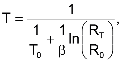

Thermistors are popular temperature sensors because they allow easy detection of changes in resistance. Once you measure a thermistor’s resistance, you can apply the following equation to find the temperature:
where RT is the thermistor resistance and T0 is the temperature in Kelvins at which the thermistor’s resistance is R0. You can find the value of β in a thermistor’s data sheet.

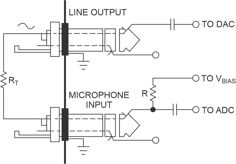

Figure 1 shows the easiest way to interface a thermistor to a sound card. The microphone input has an internal bias resistor, R, with a typical value of 2 to 5 kΩ. A dc bias voltage drives this resistor. The bias resistor connects the thermistor between the line or the headphone output and the microphone input, which forms a voltage divider with the internal bias resistor. Those components are all the circuit needs. Note that some microphone inputs may have different internal connections, so check yours before use.
The internal microphone bias resistor and the externally connected thermistor form a voltage divider.
Figure 1. The internal microphone bias resistor and the externally connected
You also need a sinusoidal signal because the sound card’s inputs are ac coupled. The sound card’s audio output can produce an ac voltage at the microphone input, whose amplitude is proportional to
You can do a simple calibration to find the output signal’s amplitude and the value of R by replacing RT with known values, such as 0 and 10 kΩ.

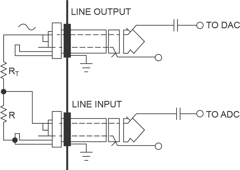

You can add second and third thermistors to your system by adding an external resistor divider (Figure 2). This approach lets you use both audio channels and a third thermistor at the microphone input. In addition to using thermistors, you can use the sound card with other resistive sensors, such as photoresistors or potentiometric displacement sensors. You can even connect capacitive sensors if you add some more components and signal processing (Reference 1).
