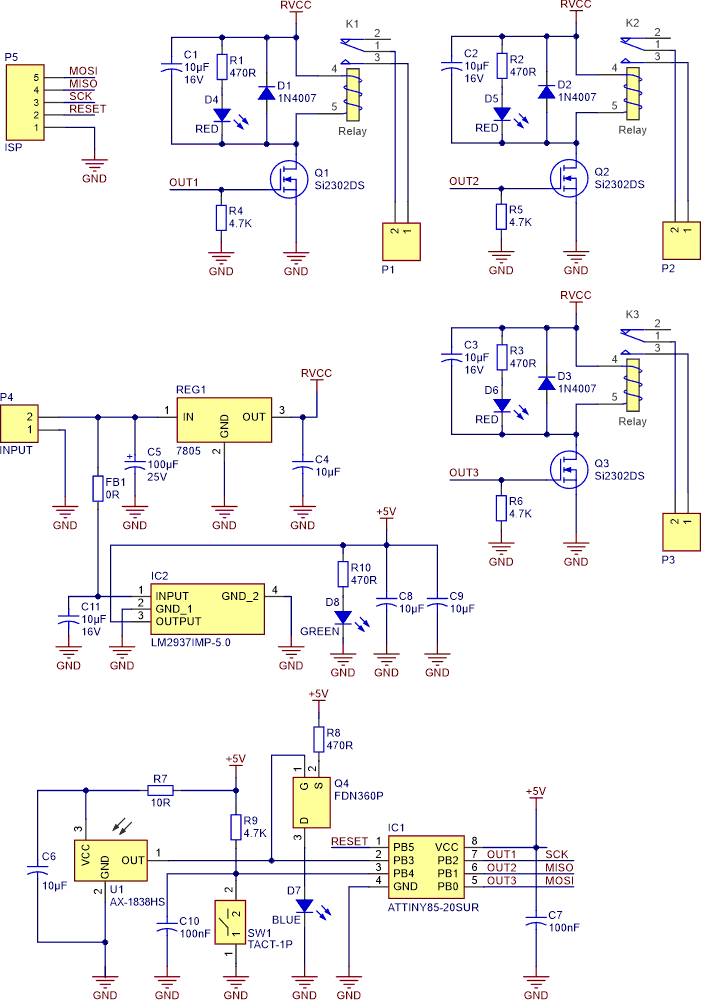

Schematic diagram of the infrared remote control decoder/switcher board.
Figure 1. Schematic diagram of the infrared remote control decoder/switcher board.
Figure 1 shows the schematic diagram of the device. Table 1 shows the bill of materials. As it is clear, both the decoding and switching tasks are done just by one 8-pins ATtiny85 microcontroller.

REG1 is the famous 7805 through-hole regulator chip that prepares fixed +5 V for the relays. C4 and C5 have been used to reduce the noise. FB1 and C11 block the input noise peaks. IC2 is the TS2937CW-5.0 regulator that prepares a fixed +5 V supply for the U1 and IC1. D8 indicates good supply provision and C8 and C9 have been used to reduce the regulator’s output noises.
U1 is the AX-1838HS infrared receiver module. This module is sensitive to supply noises, so R7 and C6 build a low-pass RC filter to reduce the U1 supply noise even further. The output of the U1 has been connected to the PB3 pin of the IC1 and the gate pin of the Q4 MOSFET.
Q1 is the FDN360P P-channel logic-level MOSFET that has been used to supply the D7. D7 is an SMD LED that indicates the good reception of the infrared signals (blinks). R8 limits the D7 current. SW1 is an SMD tactile push button and C10 debounces the push-button mechanical contacts.
IC1 is the ATtiny85 microcontroller. The ATtiny85 is a cute chip that offers 8K flash memory and can run up to 20 MHz with an external crystal oscillator. In this project, I set the clock to 8 MHz-internal. C7 is a bypass capacitor and it has been used to reduce the supply noise.
Q1, Q2, and Q3 are the SI2303 N-Channel MOSFETs that are used to switch the K1, K2, and K3 relays. R4, R5, and R6 are pull-down resistors and D1, D2, and D3 are protective diodes. D4, D5, and D6 are relay activation indicator LEDs and C1, C2, and C3 are used to reduce the relays’ inductors’ noises.
ISP is a 5-pins male header that is used to program the IC1 using an AVR-ISP programmer. P1, P2, and P3 are 2-pins right angle phoenix connectors.

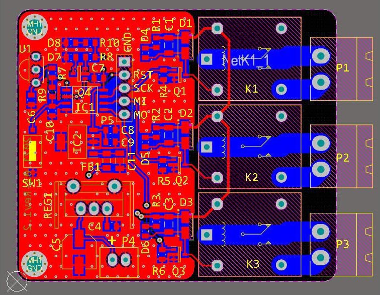

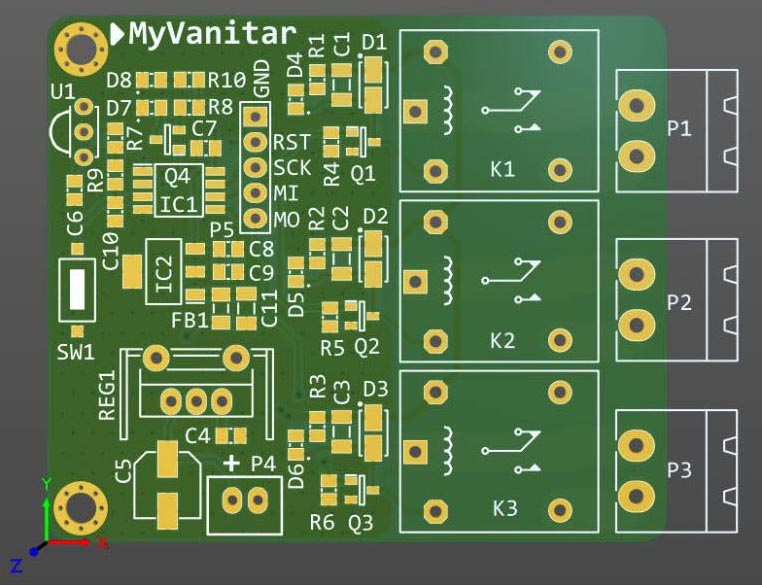

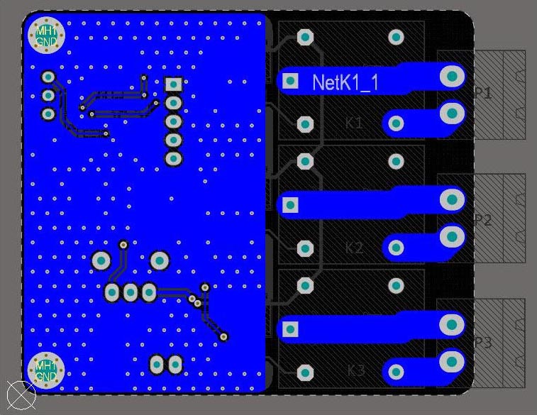

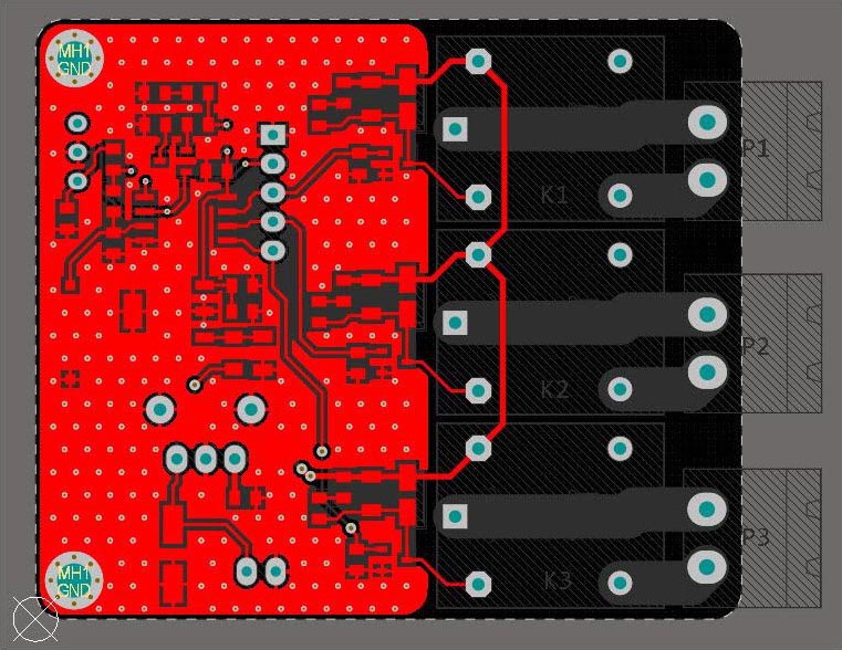

PCB layout
Figure 2 shows the PCB layout of the infrared remote control switcher device. It’s a two layers PCB board and the majority of the components’ packages are SMD.
PCB layout of the infrared remote control switcher board. PCB layout of the infrared remote control switcher board.
Figure 2. PCB layout of the infrared remote control switcher board.
As I mentioned in the abstract, I used the Altium Designer software [1] to design the schematic and PCB. It is a neat piece of software that offers a user-friendly design environment and tons of useful features. I did not have the schematic symbol, PCB footprint, and the 3D model of several components in this project. So instead of wasting my time designing the libraries from scratch and increase the risk of errors and component mismatches, I used the free and IPC-rated SamacSys component libraries and imported them right into the Altium PCB project using the SamacSys Altium plugin [2]. SamacSys has provided plugins for the majority of electronic designing CAD software, not just for the Altium Designer.
Specifically, I used the SamacSys libraries for IC1, IC2, REG1, Q1…Q3, and Q4. Another option is to download the component libraries from Electronic Component Search Engine [3] and import them manually. It’s up to you.

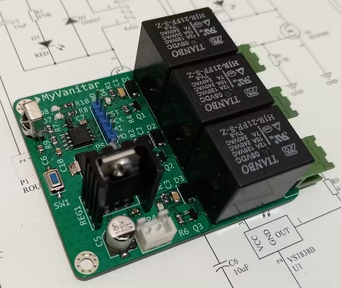

Figure 3 shows the assembled PCB board. I had no problem with soldering the components.
Assembled PCB board of the infrared remote control switcher.
Figure 3. Assembled PCB board of the infrared remote control switcher.

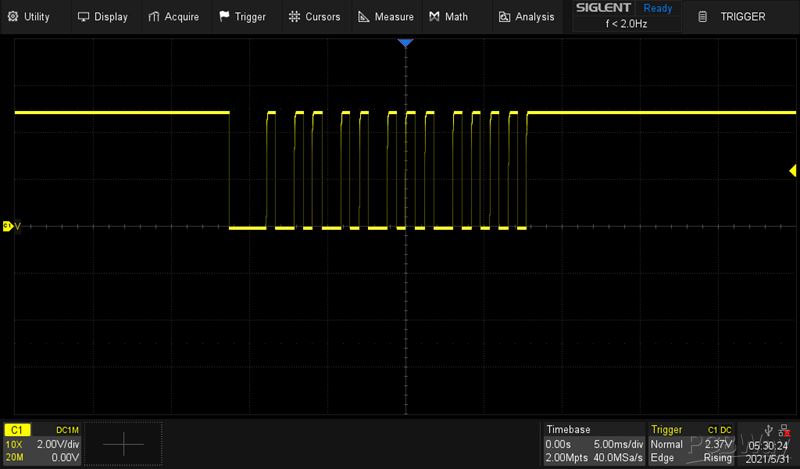

I have tested the output of the AX-1838HS module using the Siglent SDS2102X Plus oscilloscope (figure 4). You can use other models as well, such as SDS1104X-E. The oscilloscope screen says that the signal is clear and noise-free. Each remote control manufacturer might use an existing or its own infrared protocol and each remote key generates a different code, so the output signal of your remote could be different. I used a SONY HDTV remote control which naturally uses the SONY infrared protocol.
The output signal of the infrared receiver module (U1).
Figure 4. The output signal of the infrared receiver module (U1).
