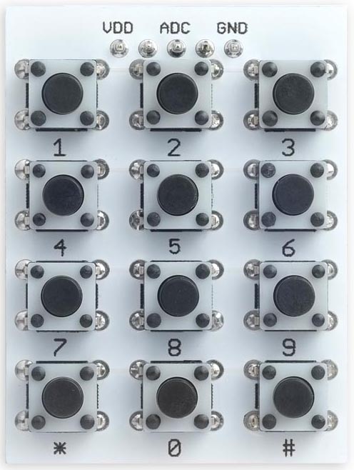

This is a 12-key numeric keypad for use in a range of microcontroller projects (Figure 1). It has the advantage that you only need one analogue input to interface it.
It's on a small 1.2 × 1.6" (30 × 40 mm) PCB, and I've also built a demo circuit to show how to use it.
The 12-key numeric keypad that interfaces to a single analogue input.
Figure 1. The 12-key numeric keypad that interfaces to a single analogue input.

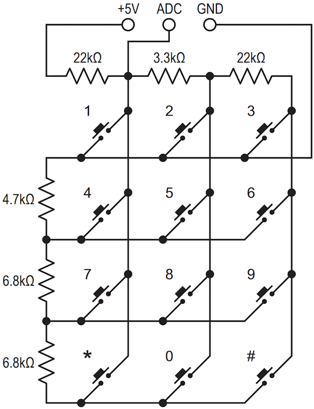

The circuit of the keypad is shown in Figure 2.
The circuit of the one-input numeric keypad, which uses a network of six resistors.
Figure 2. The circuit of the one-input numeric keypad, which uses a network of six resistors.

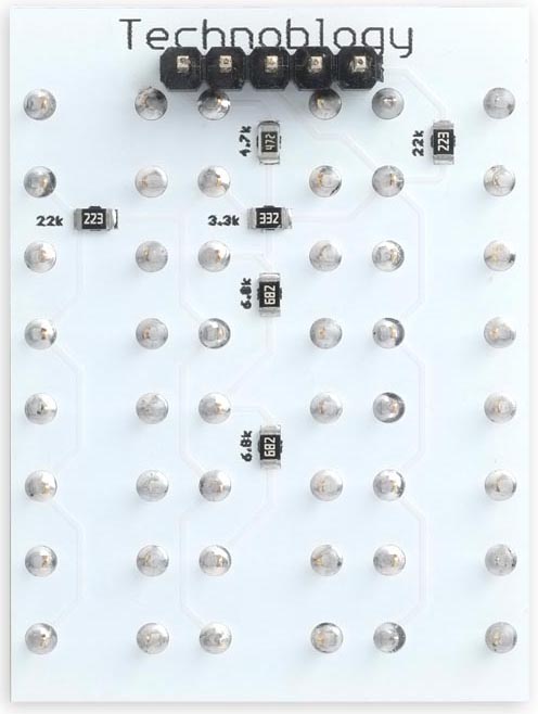

The buttons are widely available 6 × 6 mm tactile buttons. It uses a network of six 0805 surface-mount E6 resistors, arranged as a voltage divider, so each keypress generates a different voltage. It's also designed to draw no current unless a key is pressed. The resistor values are calculated to give the best spread of voltages in the available range from GND to VDD.
The '*' and '#' keys generate the values 10 and 11 respectively; they are useful for functions such as Enter and Delete. The surface-mount resistors are mounted on the back of the board (Figure 3), and the three connections are brought out to a five-way pin header at the top of the board (only three of the pins are used):

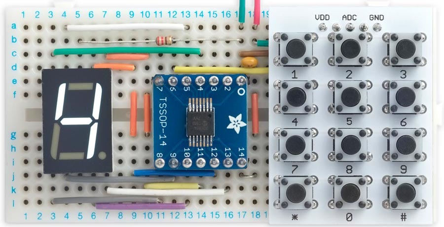

Demo circuit
I built a simple circuit to demonstrate the keypad by displaying the key pressed on a seven-segment LED display (Figure 4).
 The demonstration circuit for the one-input numeric keypad, based on an AVR32EB14, displays the key pressed on a seven-segment LED display.
Figure 4.  The demonstration circuit for the one-input numeric keypad, based on an AVR32EB14,
I built the demo circuit on a 360 hole breadboard, using pre-cut colour-coded jumper wires to make the interconnections easier. I used an AVR32EB14 in a TSSOP-14 package, mounted on a breakout board and a 0.56" single-digit seven-segment display. The display is driven directly from the eight I/O pins PA0 to PA1, PC2 to PC3, and PD4 to PD7, with a 220 Ω current-limiting resistor from the common cathode to GND. PC0 is used for the analogue keypad input.
