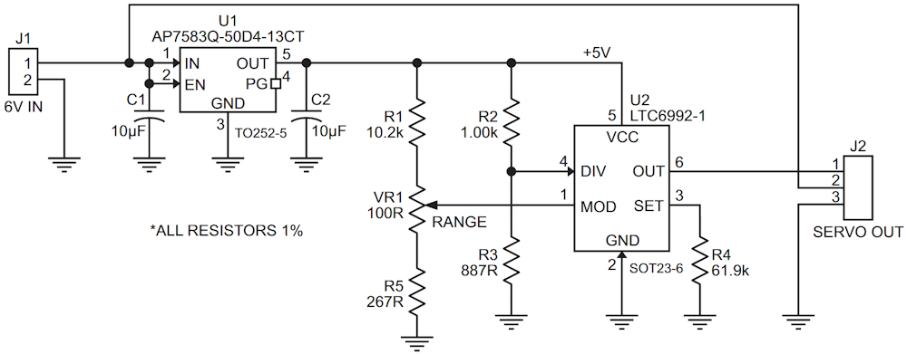

I work at a university where I’m charged with designing and developing all manner of circuits and systems for students, faculty, researchers, and the like. These circuits include a diversity of projects relying on the standard remote control (RC) pulse-width modulation (PWM) signal for their operation.
This signal is generally defined as a TTL pulse train having a frequency of 50 Hz and a width ranging from 1 ms to 2 ms. While these parameters can be programmed into most waveform generators, alternatively having a small, dedicated-function gizmo at the ready can prove to be really convenient! Figure 1 shows what I came up with.
Simple, compact circuit conveniently controls devices and systems
Figure 1. The standard RC PWM signal used to control a myriad of devices is usually obtained using transmitters and receivers. This
alternative RC servo operator circuit implements a convenient alternative jig that simplifies attaining various testing objectives.
Components C1, U1, and C2 comprise a low dropout 5 V regulator. More generally, any 5 V regulator IC can be employed, so long as the dropout is under a volt. Typically, RC servos run on 6 V, though some will run on as many as 8 V. The nominal input, indicated as 6 V here, is forwarded to the servo output for convenient experimentation as shown.
he PWM source is based on Analog Devices’ nice-and-simple LTC6992-1. The trick is selecting the right resistor values, which are shown in Figure 1. Rather than generate a PCB, I soldered up the circuit using proto-board, through-hole components, and adapter boards for both ICs. If done on a PCB using surface-mount components, the entire circuit will take up only about 1 in2.
I don’t personally keep an RC transmitter and receiver combo in my lab. Even if I did, I’d need someone to manipulate the controls while I measured the values of interest on the system I’m developing. With this handy alternative circuit, I can run all my tests without human assistance, not to mention without the RC hardware. It has proven useful on numerous occasions.
